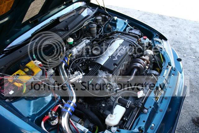

This guy came to me with a H22swap and a 700Usd SSAC turbosetup.
I thought well, It will work....
Well here are the results,
At 10psi the car produced 321,7WHP
I was amazed over this stock JDM H22 producing this much, after going through the fuel and ignition curves.
The plugs were also checked after the last run,and looked exelent.
Dynoing whas done on pump gas.
Setup.
Stock JDM H22 (10,6:1comp) at 10psi
700Usd SSAC setup w a china t3-t04
550cc injectors.
Walbro 255lph.
Engine bay
