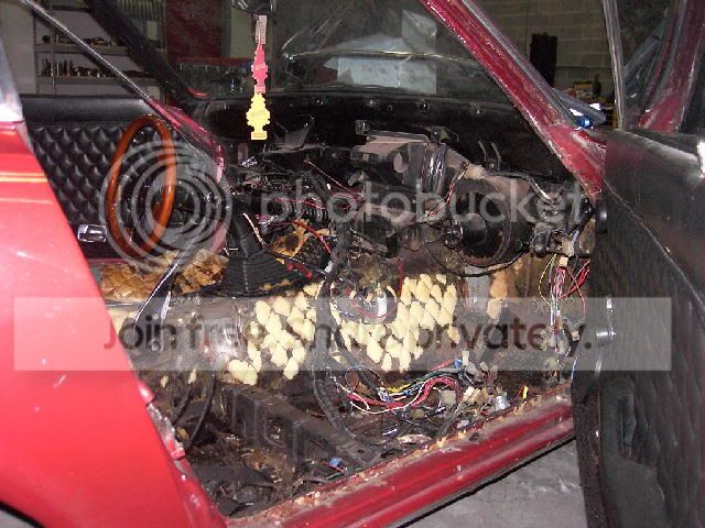

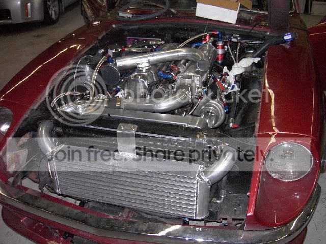

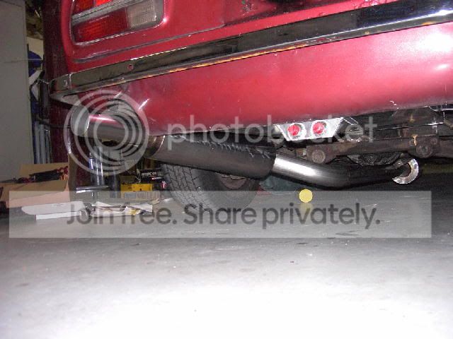

just found some pics of one of mycustomers cars he finallly posted up
did this car last month
old school datsun 280Z with a L28ET motor
t3t4 .57 trim with stage 5 turbine housing
SpoolinPerformance 3" downpipe
SpoolinPerformance 2.25 to 2.5 FMIC pipng
SpoolinPerformance external gatted stock cast manifold
3" exhaust
no cats
Spearco FMIC
turboXS RFL
tial 38MM wG
Billet fuel rail
aftermarket injectors
HOWES alum radiator... i had to weld brackets to keep the FMIC and the radiator up
some pics

Wow, the engine bay looks cool...the interior could use some recaros and carpet...workmanship looks really good as well.

projectDC2 we should compare some notes and stuff....i absolutely hear you on the frustration and 2x as long on non=honda cars. but like you said....usually the non honda guys arnt on as much of a tight budget, and cars like these obviously stuff has to be custom....so you can charge accordingly. honda stuff is getting pretty bad. its like you make 5 bucks on a 1000 dollar part now. car looks pretty good!
yea the interior is out of this car because we are doing a full cage, and im completely rewiring it inside (already did electromotive TECIII in the engine bay) im not looking forward to the interior. and yes he is doing leather recaro's i beleive, all new carpet, new fiberglass dash (im not doing that)...he has like 2 grand in guages....the whole rear is going to be all stereo'ed out....custom HRE wheels...and a custom wide body kit. when it leaves me it goes to the body sohp...then when it leaves there it goes to the stereo shop. must be nice.
