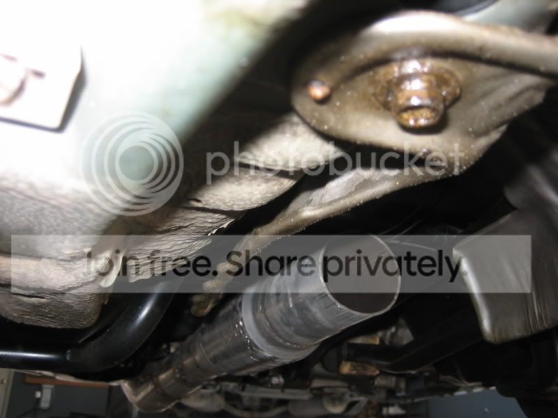

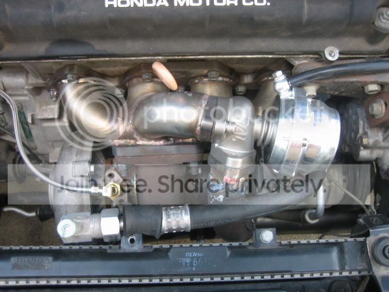

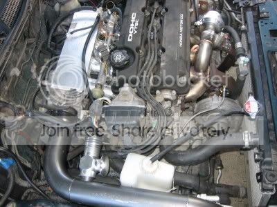

Pics of the monster:
Its open DP for now, but that's going to change once i get some 2.5" 3bolt exhaust flanges. Also, i dont have a radiator fan because i'm waiting on a slimline.

damn. time for some cleaning under the hood amigo! hahaha. looks good though. glad to see another turbo'd green teg. did you get tuned yet?

not tuned yet and i'm still cleaning up under the hood...i have to tuck some wires away if you didn't notice....there is a BIG bundle of wires where i wired the resistor box. I have some fine tuning to do under the hood, then get it tuned, toss on the exhaust and rip it up!!

Justa fyi...over time that ac line is going to melt most likely.
I would make a bracket that holds it a little more towards the rad support and away from the mani/wastegate.
Trust me, I melted 4 inches of my low pressure ac lines, completely gone!! I had to end up making custom lines cause of my manifold.

maybe heat wrap the lines.

i had the same problem, burnt right thew the line. then i got some heat wrap, http://www.autobarn.net/thhowiprbyth.htm haven't had a problem since. looking good btw lets see some numbers
