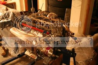

Hi all, I know this will not be a direct tech post but if moderators want to delete it, go Ahead.
First off I want to thanks people that has been somewat involved from tips, to part delivering.
T1 racedevelopements
Tony, My man
-Fullrace:
Geoff.
Henry (Sad that you have left)
Javier.
-TD autowerkes
Damian and Cwest
-Bullseyepower
-King motorsports
Scott.
We are located in Norway, we will move in to the new shop in about 1 1/2 week, We have our own dyno so that gives us the opportunity to test out varius of turbos, cams etc,
But for now I had to move my stuff to my private garage.
The car is a 98 Integra Type R, with some exterior mods as you can se.
The engine is a ERL sleeved, and 5main. b18c1 with 84mm sleeves
it has a GSR crank, 1/2headstuds, wiseco coated pistons, Manley rods.
Delivered by Damian
We have ported the head, and installed Supertech valvetrain included Rollerrockers and rollercams.
4x 1600cc injectors, 2 walbros feeding one Aeromotive pro series fuelpump.
It has a Fullrace intakemanifold, and a T4 Splitpulse Exhaust manifold.

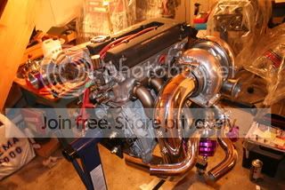

I have three turbo`s to use, one custom GT4094R with a gt42 (70mm) Compressorweel on a gt40housing.
One GT4202R (74mm)
And the final "Blockbuster" BW S480 with a T4 Ex housing(I belive that degrade the turbo to a s380, correct me if Im wrong)
Nice goodies Geoff and Bullseyepower.com.
a 80mm Mustang TB, The IM is portmatched and reworked for the TB.
The management will be a motec M4 system,and a t1 trigger Im waiting this and a lot of other stuff now, delivered by Tony.
I will also use Avid solidmounts and a G force shifter
The Mounts will be here tomorrow and I will install the engine in a matter of a week.
Hoping to get this ready to dyno for late april it will be dynoed on VP Import(OMG it is between 90-99USD roughly estimated price per Gal to use that here in Norway.
Maybe q16 will be a alternative for other than dynoqueening lol

We definitely need larger, high res pics of this. Is that a wiggins on the TB? Full wiggins clamped charge-piping? Anyone who springs for wiggins clamps is automatically my hero.

<TABLE WIDTH="90%" CELLSPACING=0 CELLPADDING=0 ALIGN=CENTER><TR><TD>Quote, originally posted by Legion &raquo;</TD></TR><TR><TD CLASS="quote">
We definitely need larger, high res pics of this. Is that a wiggins on the TB? Full wiggins clamped charge-piping? Anyone who springs for wiggins clamps is automatically my hero.</TD></TR></TABLE>
Is this good enough? I will post up some more pictures later on too.
Note the "Small" 42 in the back

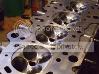

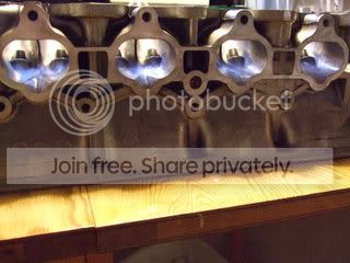

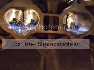

I do not have any pics of the Head of this engine, It is a p72(Gsr head) we worked the combustionchamber and deshruded the valves.
the Intake ports were calculated, and D shaped, the exhaustports was shaved with wide side and a tall roof, with the right shape.
The Intake seats were aplied unconsetric angles and only a 1 angle job for sealing.
The exhaust seats were done with a two angle job and one calculated radie instead of the 60*
We did bore down the exhaust guide to the port roof.
The head pictured is not the head for this engine, this is a p73head (Yes we doug in to the hype R) It looks okay from factory but I really dont like everything done to it, I think the stock b16 and p72 head are nicer to work with) that we ported for a customer but you get a neat idea.
Just Imagine a tad bigger ports.
