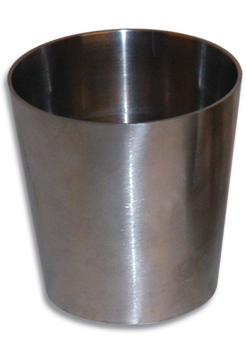

I have an sc44 and the turbine has a 4 bolt 2.5" outlet. Should I just fab a 2.5 downpipe with a vibrant 2.5-3" concentric expander (shown below) after the first downturn or would it be better to do 3" straight from the 2.5" flange?

The conical is a great upgrade for those that don't want to go through a lot of work to use a flange for the 2.5" discharge to a 3" discharge. There's no need to weld straight to the turbine housing itself.
Well I wish I could go straight out like that. Problem is alternator clearance and I am keeping a/c so there is gonna have to be a down turn on the pipe before I can add the transition. Basically I am asking will I lose any power over making a DP like this(see crappy paint pic) rather than straight 3inch pipe from the 2.5" flange?
