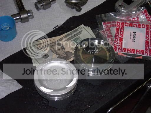

I need to know the answer to this. My buddy dropped off his block for sleeving and assembly. His pistons were used from a previous build and when he picked up his block the pistons were sand blasted. The machine shop told him that he did that cause the pistons had some carbon build up on them. Is this ok???

This was why I was concerned. I will post pics of them!

Kewl I thought it would be bad! I dont know if the shirts were blasted you can't really see. Good **** then! Thanks
