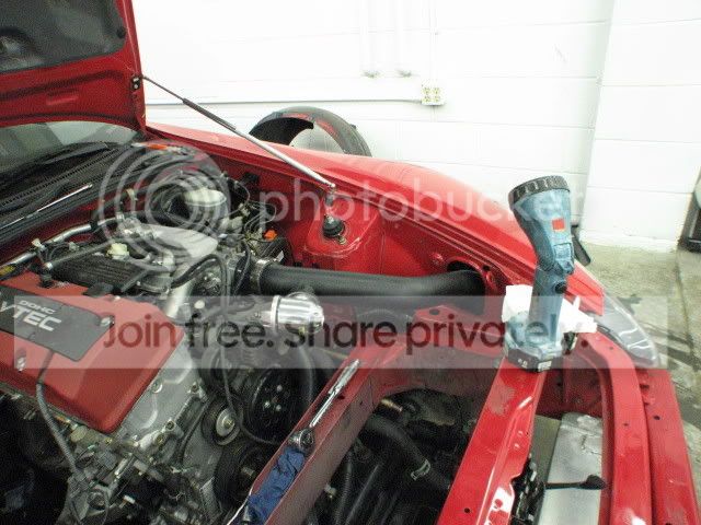

I upgraded to the 44mm WG and full race mani
Here it is after i just got done blasting it
Im currently Comptech Supercharged and aftercooled(FS BTW), running 305HP @6psi.

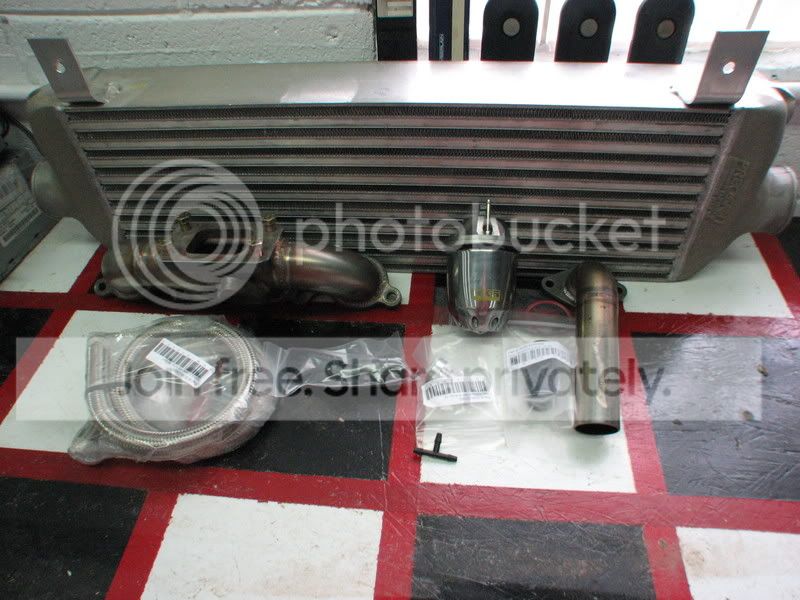

But I want more power and more torque at a lower rpm. So this is what I have in store.
Im shooting for 400WHP
Garrett GT3076R Dual BB
Tial 38MM WG
PFab Mani
2.5 Stainless IC Piping
Precision 600 Intercooler
RC 660 injectors
HKS SSQV BOV
Summit Racing Oil Return
Only thing left is oil feed and AEM EMS

Looks good, those 660's are rated to max out around ~425hp. You may be getting to their max. Im running 780cc's on my 400hp setup.

for only 400whp, I would use the GT2871r, T3 .82 a/r. Much better spool time and better matched wheels. It'll max out around 450whp.

yea that turbo does seem big for only 400whp. It will make closer to 500-550whp.

nice!!! got any pics of the relocated fuse box? are you still running windshield squirters or did you remove the resivor in place of the fuse box?

nice!!! got any pics of the relocated fuse box? are you still running windshield squirters or did you remove the resivor in place of the fuse box? </TD></TR></TABLE>
Here you go

Do yourself a favor, get bigger injector. Why run a big turbo so you can make more power later and not do the same with your injectors??? The price is pretty much the same for 650 or 880.

Log manifolds suck on S2000's. The good flowing head and decent size cams hate a log manifold. With the log you'll end up having to put vtec up around 6500, where with a good tubular manifold you'll end up with vtec around 4000, which should tell you how much difference in flow there is between the two manifolds.
