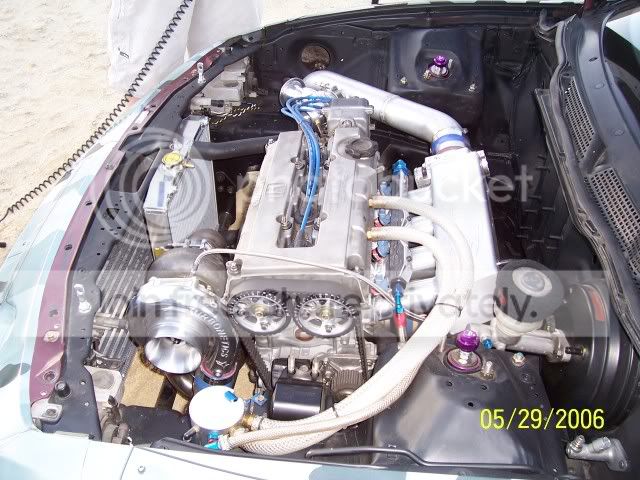

heres mine and i never had oiling problems, but then again i mde my own baffle for the fittings. it really doesnt take that much time and it works really well
