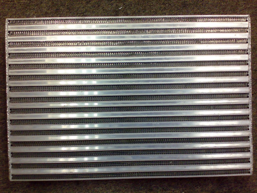

It could be old stock, post a pic of it... A Garrett core is simple to ID

How do u Id a Garrett core ?
Old Oct 29, 2013 | 03:53 AM
wantboost's Avatar
Who is Mr Robot?
Posts: 21,474
Likes: 10
From: ATL - Where the Pimps and Players dwell
Default Re: precision 750 users or vibrant 875 users
Very simple, here are some pics
Face of a Garrett core
Face detail, showing fin design and density.. Also notice that each pressurized air passage extrusion has a "lip" at the top and bottom of each one (ETS cores also have this lip but are not Garrett cores but are of a similar design)
Looking inside an endtank of a Garrett core, shows fin design and density. Note the small bands of tig welds, Garret does this on almost all of their cores)
Another angle of a Garrett core with no endtanks. Here you can see the tig welds I was talking about, normally Garrett does this at the top and bottom of the pressure side of the core, or wherever the inlet of the endtank will be.
You can also see the lips on the extrusions I was mentioning.
You can also see the complete construction of the core (ebay cores dont have that point on the extrusion of the pressure side fins) showing the design differences in ambient and pressure side fins, as well as fin density)
Full view of the pressure side of the core
Hope this helps.
I think after Precision lost their Garrett supply contract, once they used up all of their remaining stock they went to china/ebay cores... at least this is what I have been told. Unless they went with a company like ETS...
Precision has started using proprietary materials in most of their products but IIRC they don't have the ability to produce their own intercooler cores, at least not yet, if ever...
