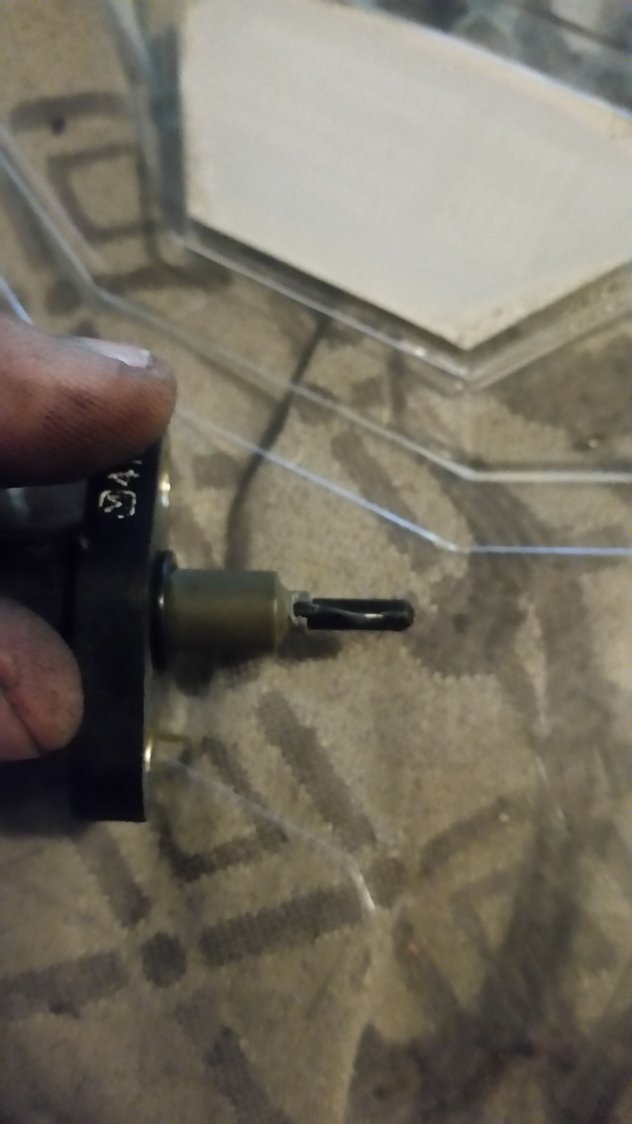

Hey so I read before about modifying the iat to be more of an open junction (wantboost)
I had a set of xactos like wantboost described so thought I'd see what I could do.
is this enough or do I need to keep going into the black plastic and actually fully reveal the junction? Im thinking yes since wantboost said it wss difficult as f*ck and so far this wasnt bad, thoigh expecting to f*ck up from thei advice might have helped. But if you fully reveal it, dangling by thread wires, get sucked into engine? Or you leave ejough plastic to hold everything together?
What about the extra grey plastic on the base? Thinking it is extra thermal mass but also isn't covering the junction.
might have to add iat scaling as an option to hts...
then we can use gm.

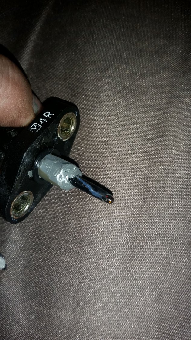

I'm OCD..couldn't stop..
assuming this must be close to what you're supposed to do:
tried taking some material off the base but it's just a PITA.

99.9999% of the temp sensors take readings from the tip.
As long as that circled area is exposed, you should be good.
Most people just run the IAT in the intake, before the throttle body, instead of doing this particular mod, or an S2k sensor (if I'm not mistaken). These sensors are touted to be a bit less responsive because of the plastic in which they're encased, so they get shaved (like you did here), or swapped. I could only imagine shaving one and then relocating pre-TB. Could be interesting. lol
