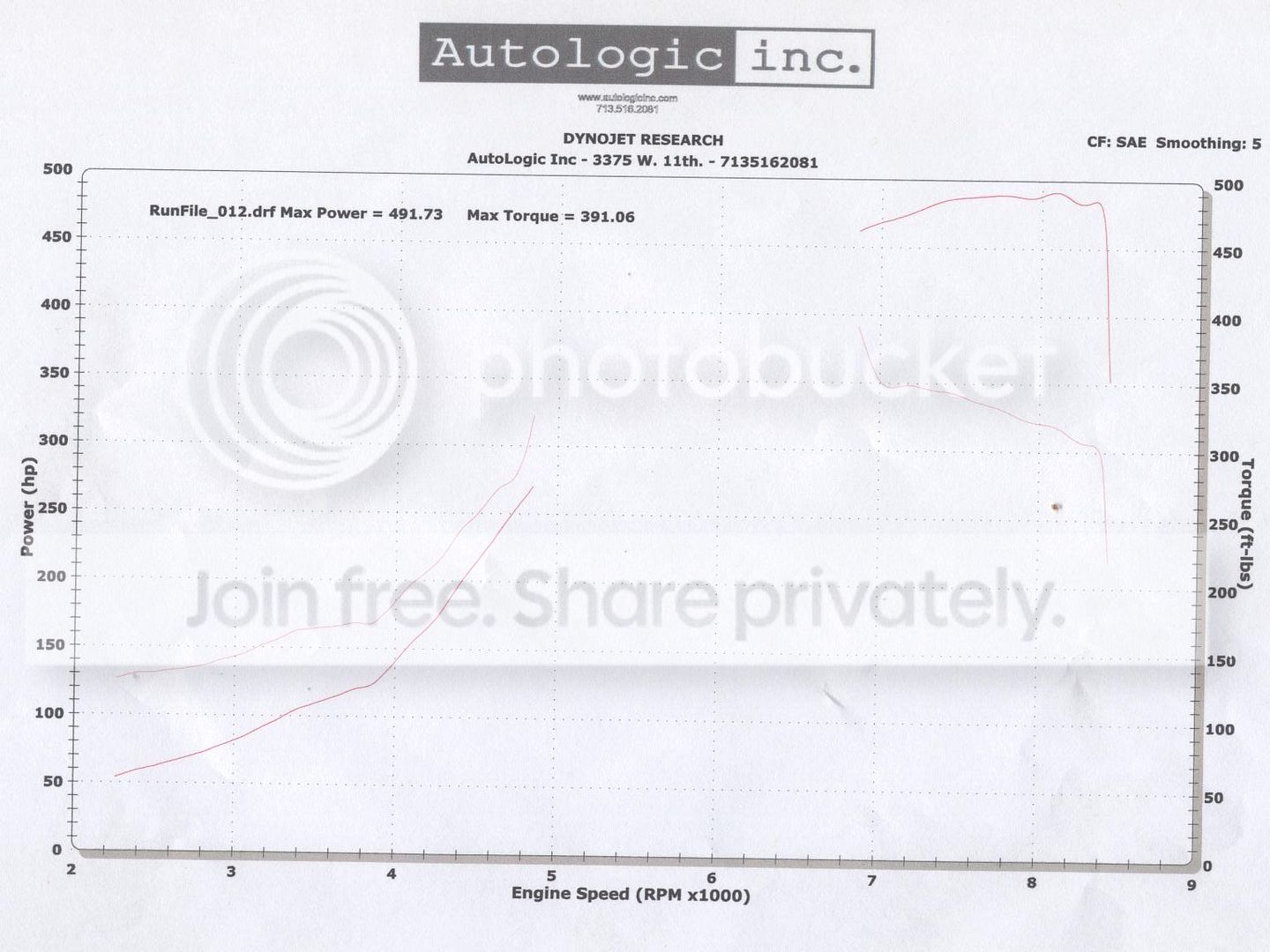

Well, our last setup we did locally finally made it to the dyno and I am proud to say it did good! We were having problems getting a good ignition signal.
The dyno runs were done with 93 octane pump gas, no bags of ice on the intake manifold, starting to heat soak, 100+ degrees in the shop.

heres the graph in rpm's and tq but as you can see it broke up then came back

I dont mean to sound like a dick, but Khiem (the owner of the accord) Paid a good amount of money for his maps. Asking for someone's maps is like asking someone for a part off the car.
However, it sounds like you are more curious about the tune than the maps to plug into a car.
When I tune a car on pump gas I run the car very rich usually to keep cylinder temps low. I also try to run as little timing as possible to reduce the chance of damage due to bad gas.
On Khiem's car I ran the AFRs in the low 11-high 10:1 range. The total timing @ 18psi was around 14 degrees AFTER peak torque. This is probably WAAAY to conservative but it still made clean power and lots of it.

Nice job! Damn that Stoopid, he's beating the hell out of my old dyno.. That ignition system problem is one of the many reasons I hated my Dynojet.. According to the techs at Dynojet, you should wrap the cables and your sandwiches in aluminum foil and see if that helps.
