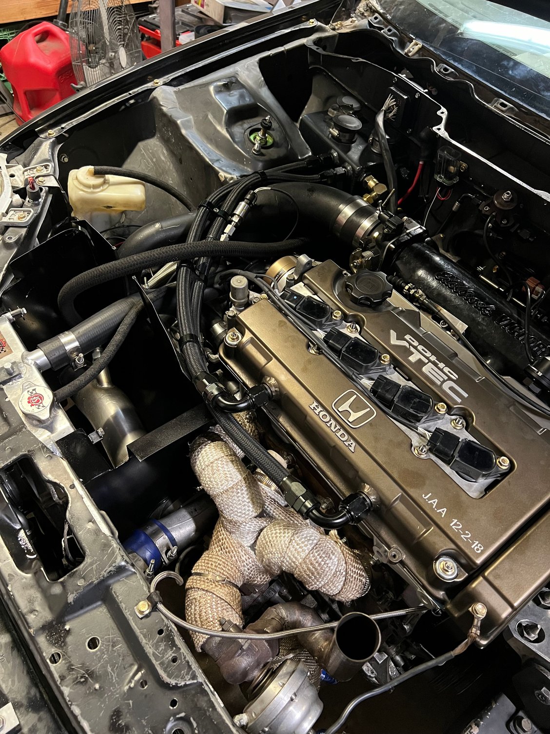

Have pictures of your setup Pepe?

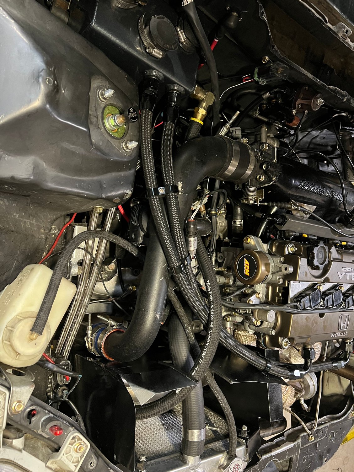

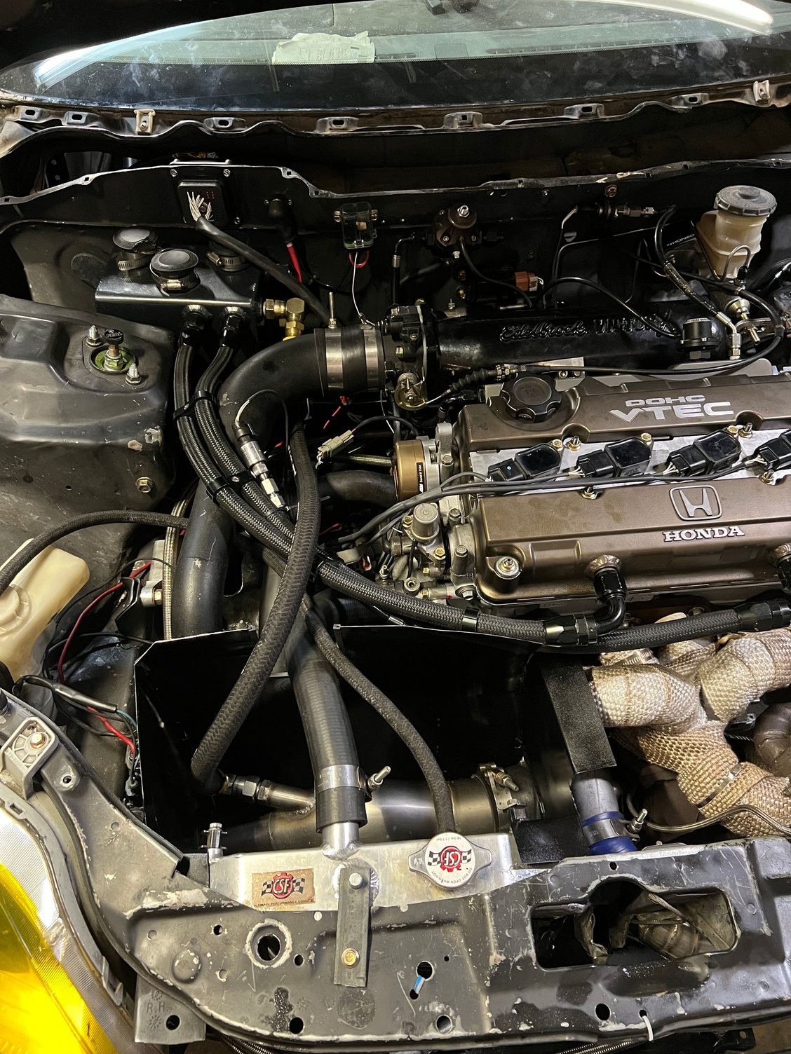

Default Re: Oil Catch Can System for High Boost?

Very interesting
So the valve cover vents to the catch can and it is sealed? Then the other side of the equation is the vacuum side of the compressor is also vented to the catch can and it never sees positive pressure?
Wouldn't this result in the turbo pulling in from the catch can the vapors/oil from the valve cover and you would end up with a oil covered compressor blade? I guess I'm not understanding what is going on here. The catch can never sees positive pressure, that much is clear.

Originally Posted by Stopsign32v
Very interesting
If my compressor blade, intercooler, intake manifold etc was covered in oil do you think i would still have it set up that way?
Point taken but how does it avoid this?
Oil has to make its way all the way thru the hoses into the BOTTOM of the catch can up into the top hose and into the intake. At the same time its draining back to the block with the two hoses at the back of the block.
I want to add a pressure sensor to the block to see how well this actually works verses just a vented catch can.
Ah! I didn't know it drained back into the block. So 2 ports to the valve cover, 2 "return ports" to the block, and 1 port to a vacuum source before the turbo.
No smell of burnt oil and you get a vacuum source for your system and never a positive pressure situation. Isn't that the goal to begin with?
Might look into this as a "drain back" on my system.

Hey no not 2 return ports on the block. Those are crank case vent hoses. The one or 2 you decide to run on the valve cover are venting crank case pressure from the head. The same oil galleys that allow oil to drain back down from the head also allow crank case pressure to travel into the head. Because of oil slosh on acceleration, the front of the valve cover is a popular choice. But the block has 2 vent ports (b series)
​​​The pic you posted is a great demonstration of the venturi effect
You know thats all connected inside the motor right?
