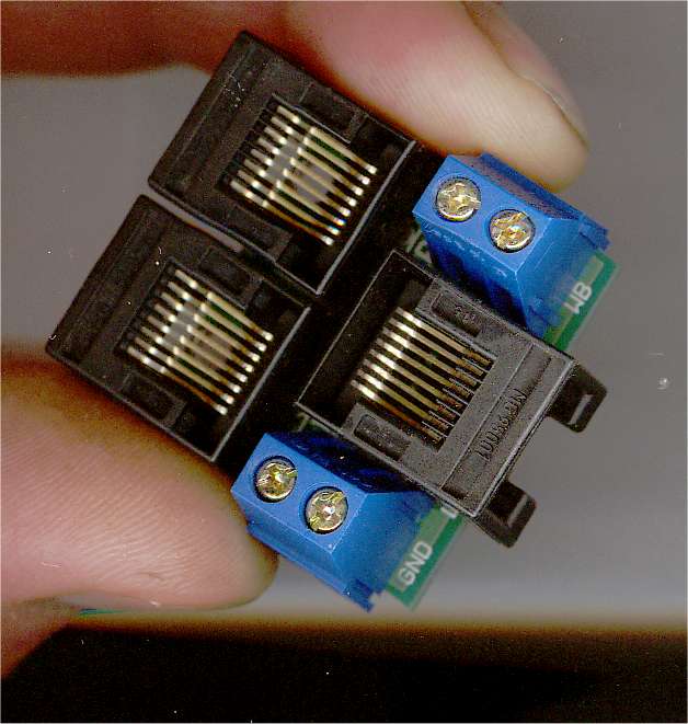

Techedge sells a splitter that has both linear 5v and narrowband screw connectors on it. Its $12. Of course, you can still always make one yourself fairly easily.

i just used a CAT-5 cable and cut off one of the plugs. then you have plenty of wire to work with and don't have to mess with crimping if you're not famliar with it/don't have the tool. although that splitter does look nice for $12
