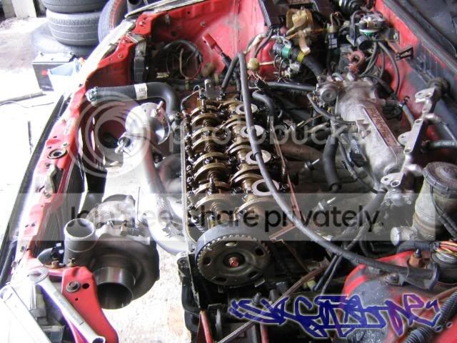

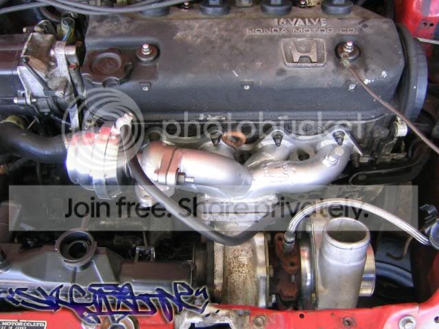

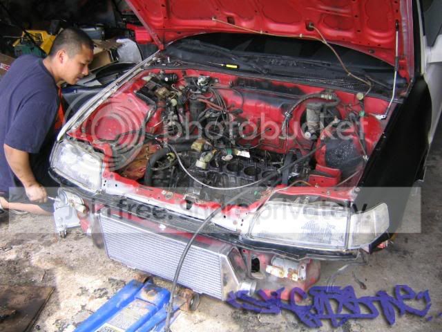

Here are the pics of the setup..everything is coming along well..still gotta hack the dual core half-sized radiator to fit and clear the hood, dp, charge pipe, and custom intercooler piping..

what did you do to the block, and what are u using as far as management??

block has all stock internals..and as for fuel management..i'm using uberdata, 450 cc injectors, and walbro 255 lph intake fuel pump

are those barnacles on the fuel rail?

LOL! Oxidation.

..btw, does anyone know if the z10 traction would make a 92-95 dual core radiator clear the hood of a crx??

Nice setup....If I remember, the z10 x-member has mounts for a half sized radiator. So yes, it will clear the nood

What manifold are you using? It seems to be hanging the turbo really far away from the block. Looks like you might have some cracking issues from the stress of holding it out that far.

its a SFP manifold

LMAO at the barnacles. I feel you though man, I have an EF too so half of my **** is all dirty. So you converted to obd-1 for uberdata? What i/c and turbo are you running? I have a half sized radiator...all I did was cut some of the radiator support and skeleton under the hood.

i/c is from yonaka 22x9x3, using pte sc34 57 trim .63 a/r
