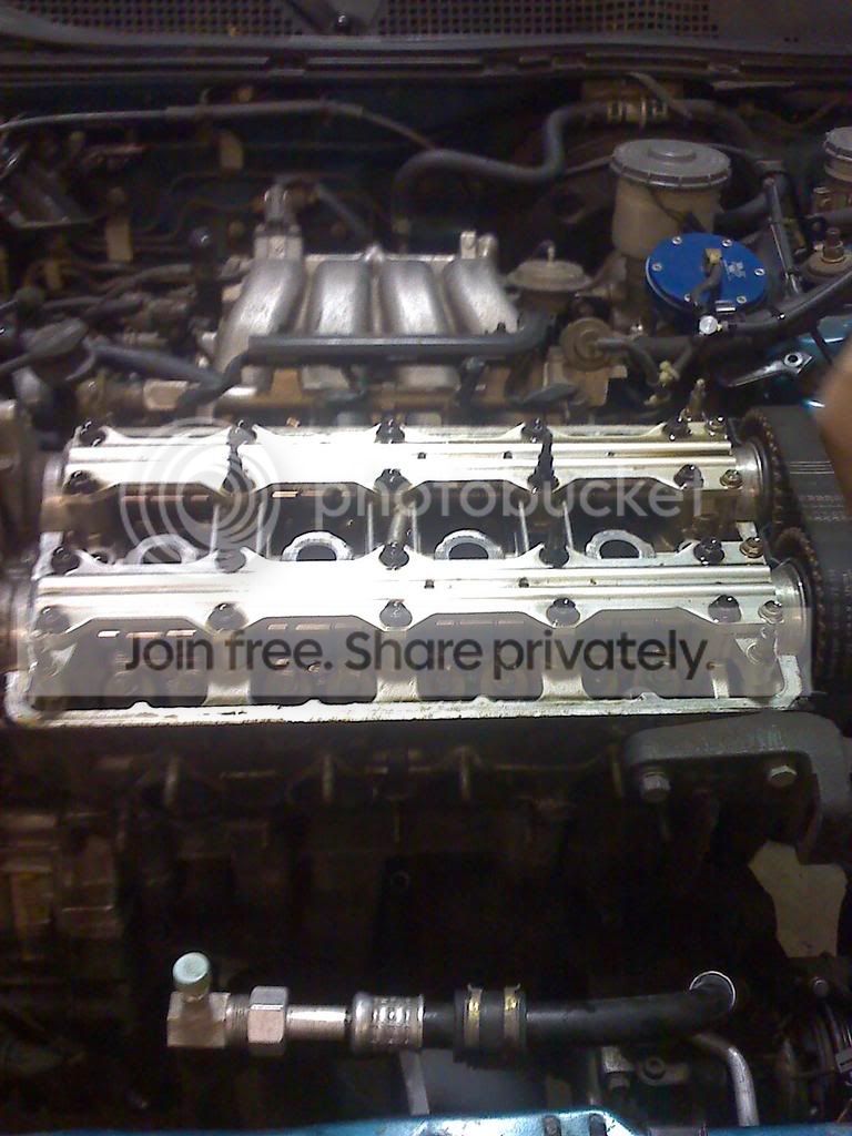

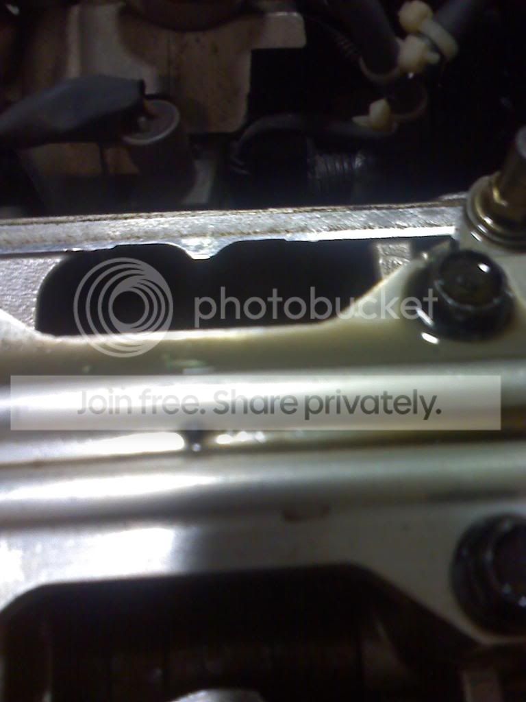

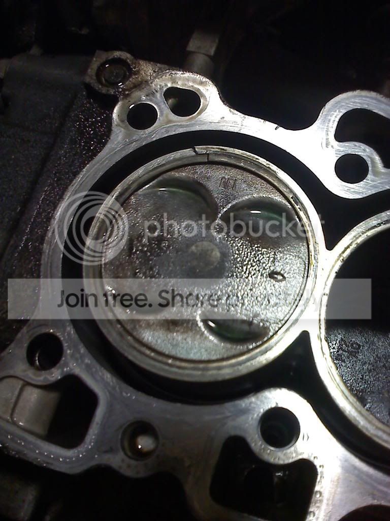

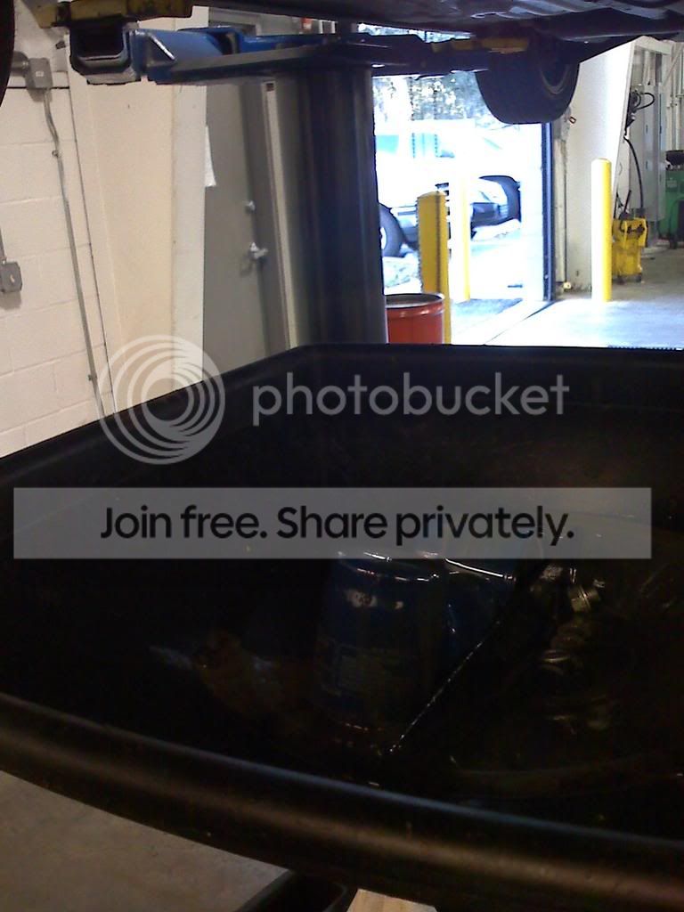

Here I am draining the oil, check out the grey murky color. (radiator fluid and oil mixed)

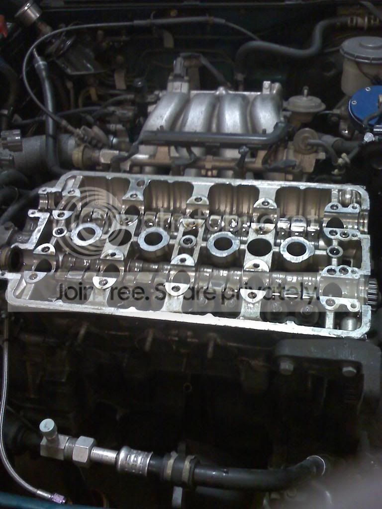

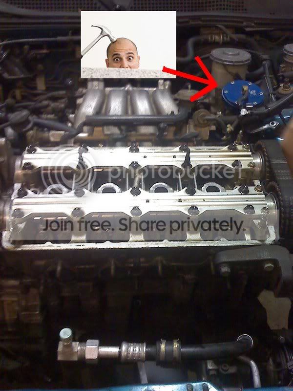

About to take the cams and gears out of my head.
Notice the radiator fluid?
Cams and gears out.

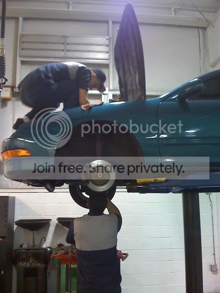

Don't ask, but this is how Acura techs take off the intake manifold.

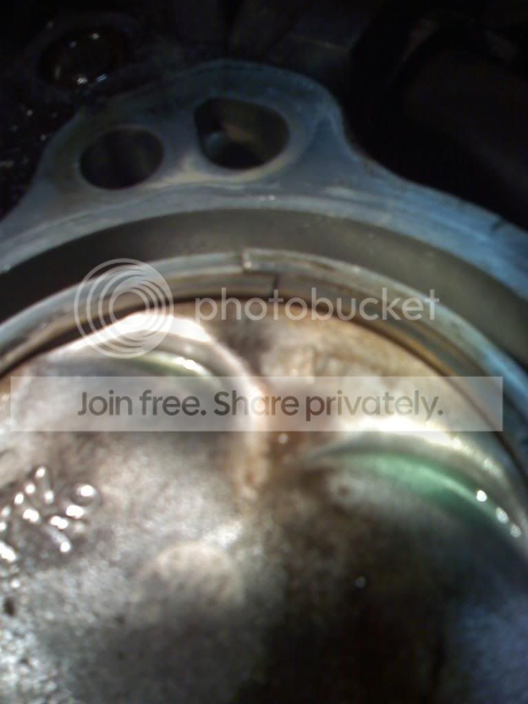

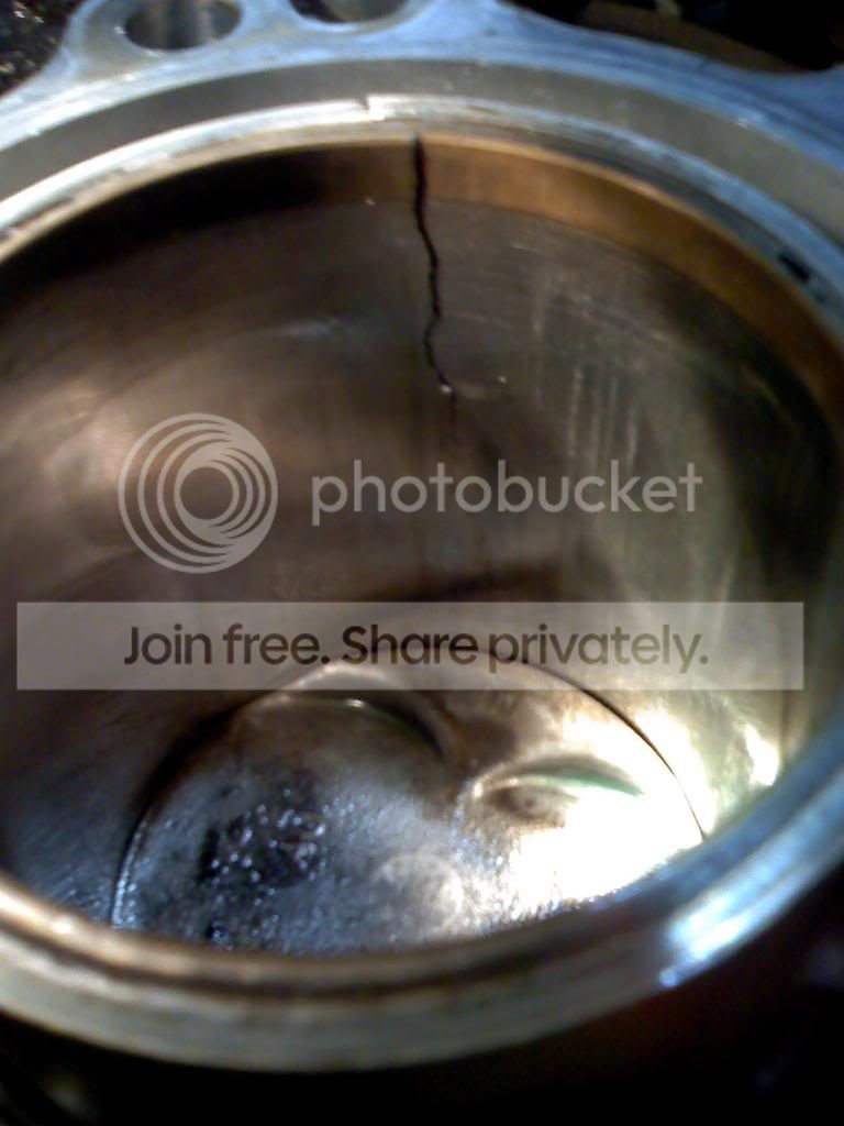

and this is the conclusion to my blown motor.

damn dude cracked sleeve ftl.Built sleeve b series ftw,what are you hp goals???? as far as for the new build????

looks like you were running an fmu. that was probably the problem. get a good tune next time and that prob wont happen

Did you have something pulling timing out? I'm assuming due to your FMU that you werent running a EMS and also had nothing pulling timing. So that nice crack in your sleeve is most likely due to detonation. Is all this correct to assume? Good luck with the new build. Some may advise to use a different rod if your gonna build such a solid setup.
