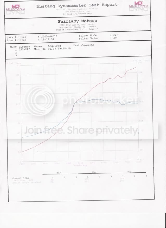

Default my gsr dyno, 375whp 252tq @ 14psi on mustang dyno
Well, after almost a year of slowly building my new motor i finally got a chance to hit up the dyno today for a few quick pulls. We put a 3bar map on and street tuned it for about 25minutes before we dynoed it. (it was a dyno day at a local shop so we didnt get to be on there for long). so the curves arent yet very smooth. still lots of tuning left to do plus some cam and ignition tuning. everything was very conservative.
car: 97 civic hatch
motor:
gsr block/head, GE sleeves 84mm, CP 9:1 pistons, eagle rods, Rocket Gen2 springs, VictorX mani, STR 70mm tb, gsr cams and crank.
Turbo:
CRP ramhorn exhaust mani, Innovative gt61 turbo, Tial 38mm wg, Tial 50m bov, 650cc injectors, walbro 255lph, 3" open dp.
CROME tuned by Eluzion
note: this was done on a Mufstang dyno
VIDEO:http://66.49.162.14/speedlinew...o.zip(our first video, video quality's not too great)
375whp 252wtq @ 14psi (redline 9k)
been to the track once and ran a best of 12.04 @ 118mph on 12psi. car was boggin a lil on the new 25's and I can't drive
1000cc injectors, more boost and some dyno tuning comin up in the next couple weeks

Who has the Mustang dyno? I can olny seem to find Dynojets locally. I prefer to tune on a Mustang if possible. Nice times BTW.
-Ryan
EDIT- DOH! Should of read the dyno sheet..LOL!

haha, the dyno sheet isn't too clear. but talk to Doug @ Fairlady Z , 253-565-9823

thanks guys. I'm trying to get a better copy of the dyno sheet, all the numbers are too light to show clearly. but thy dyno graph ends at 8500rpm

Mostly stability, but also usability.
The car wasn't really tuned though. Created a quick basemap and adjusted the AFRs on the way to the dyno. Left everything on the conservative side. Cam gears are still zero'd out too. I think after some ignition/cam timing tuning (and a strong valvetrain to let it scream.. thing kept wanting to go), it should see upper 400's (DynoJet/DynaPack). I think that is about as high as I'd want to go on pump gas though. Really need his 1000cc injectors and throw some race gas in there...
