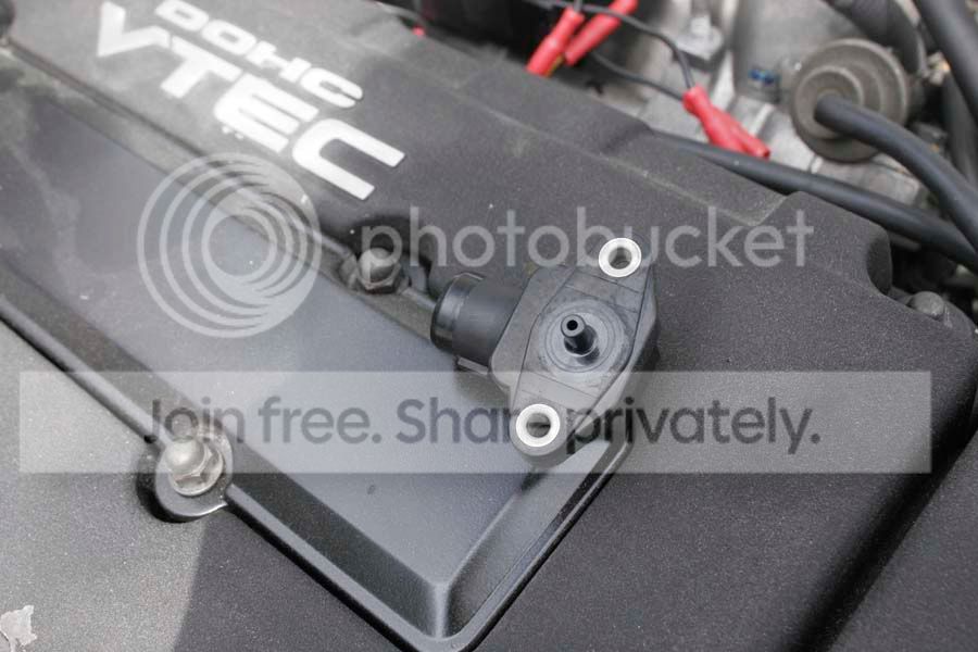

<TABLE WIDTH="90%" CELLSPACING=0 CELLPADDING=0 ALIGN=CENTER><TR><TD>Quote, originally posted by USDM 4G VTEC &raquo;</TD></TR><TR><TD CLASS="quote">be careful when u mount it
dont put too much pressure on it
if u bend the casing, it will not read right since the package is small and u can distort it</TD></TR></TABLE>
Did you just screw it straight onto the firewall? or did you fab up a little mount for it?

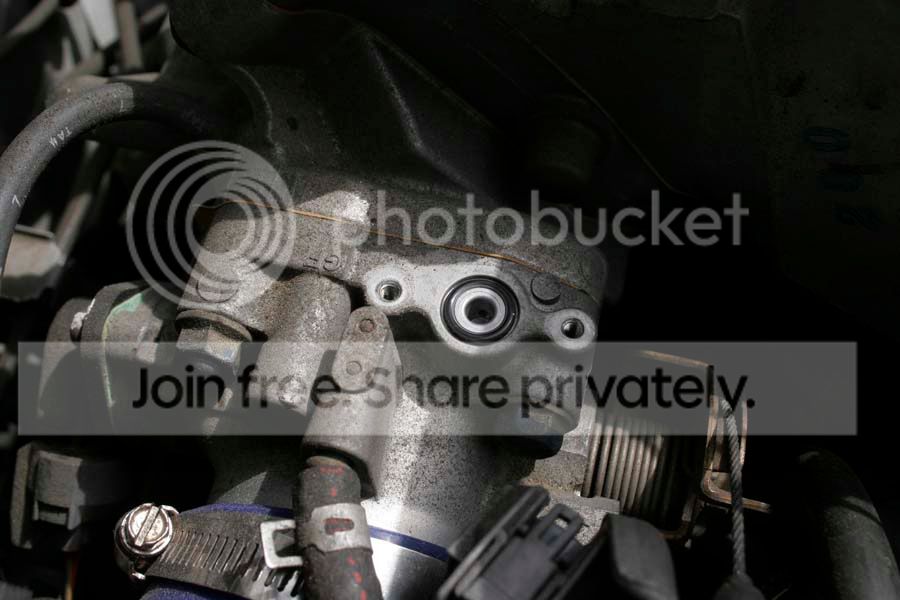

And if anyone has any pics of one installed on a b18c?
Stock Map Sensor
The problem? should i just make a plate and run a hose out to attatch to the motorolla?
Thanks

Just leave the OEM one in or fab a block off plate and run a seperate vac line to the MAP sensor. Don't connect a bunch of crap to the line either, I like to give the MAP sensor its own vac line.

<TABLE WIDTH="90%" CELLSPACING=0 CELLPADDING=0 ALIGN=CENTER><TR><TD>Quote &raquo;</TD></TR><TR><TD CLASS="quote">Just leave the OEM one in or fab a block off plate and run a seperate vac line to the MAP sensor. Don't connect a bunch of crap to the line either, I like to give the MAP sensor its own vac line. </TD></TR></TABLE>
What vac line do you suggest I use for the most accurate reading?
