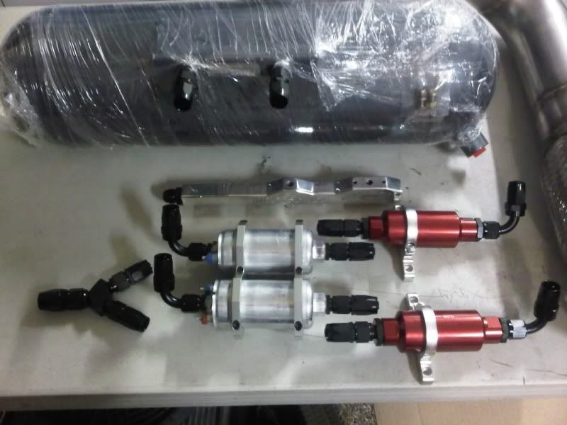

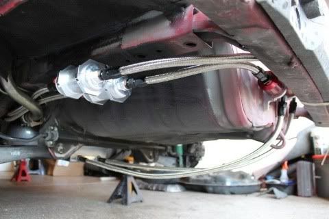

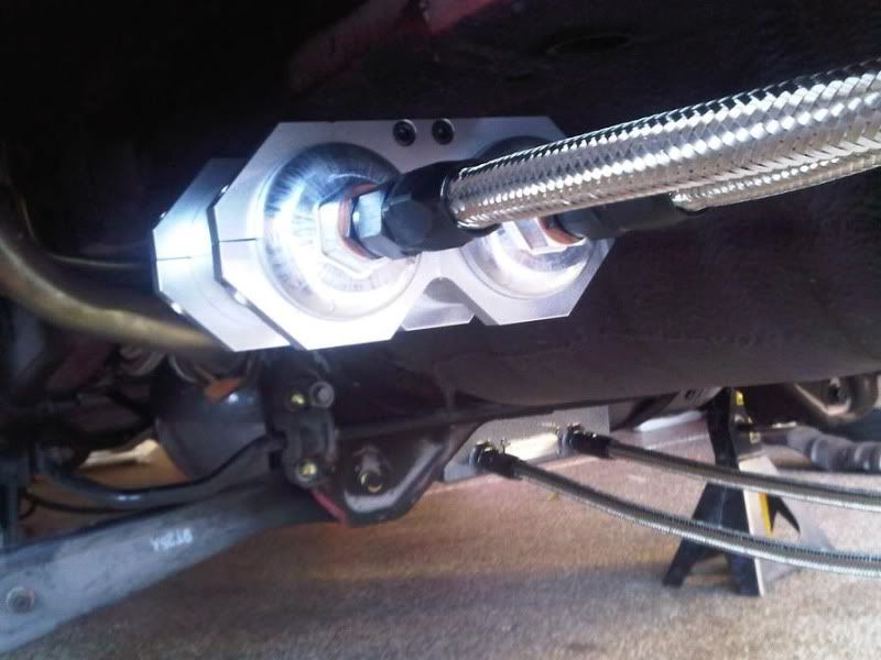

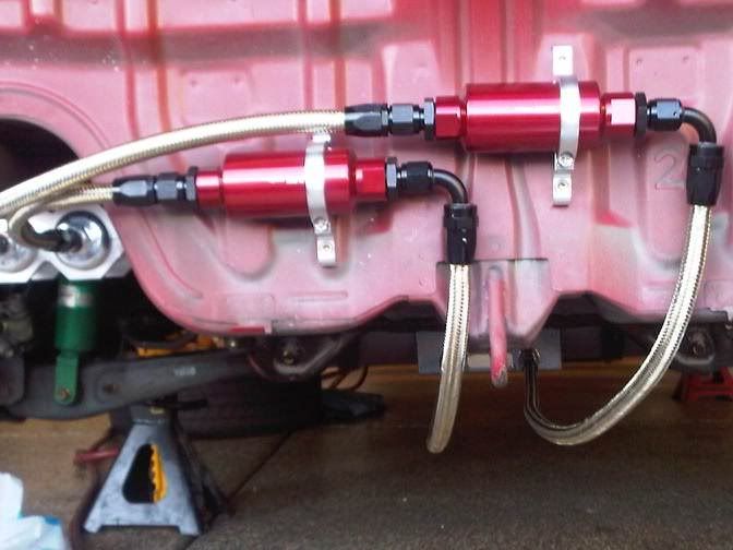

Fuel setup. NRG tank, Duel Bosch pumps, #2 40 micron ss aeromotive filters (before pumps), #1 100 micron engine bay filter (removed), GE fuel rail, ID 2000, fuellab fpr set at 65 psi, fuel lines two -8's Y int one -10 upfront, -6 return.. Running e85
During tuning inj were at 89% duty cycle at 25 psi. We thought filter might be dirty so we removed the engine bay filter. Still same prob. Got off dyno inspected and cleaned both pre pump filters, they were like new still clean. What else could the problem be? Hondata s300 tuned by Daniel from churches
Any advise.there is no way we should be close to maxing out the injectors at 25psi.
Some pics of the fuel set-up

This is a valid question that I caught too. Your filters should step smaller in sequence. Going from 40 micron to 100 micron is backwards. Thats like using a coffee filter and then chicken wire. Alot of people make this mistake.
Another observation is the physical size of the 40 micron filters. The amount of surface area vs the micron rating is responsible for the flow. I have a single 10 micron filter after my pumps but its way bigger than yours. What model number are the two 40 micron Aeromotive filters?
Are you sure your filters are Ethanol compatible? If not the Orings can deteriorate and possibly clog.
