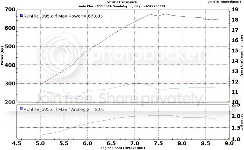

Setup:
GT35 .63
85x89mm displacement
rollerwave pistons
bumpstix cams
ported head
AIR intake manifold
custom top mount
Tuned with:
Hondata S300
Boost by Gear
Fuel System:
dual walbros
1600cc injectors
E85
SAE corrected is 659whp @ 28psi
what do you think guys.
is the gt35 too small nowadays? should the setup say hello to s366? or s372? car is dd with a/c p/s.

what do you need more power for?? lol isnt 675 good enough for a dd??

it is, but dont you want more if you can have them? lol.
is it the flow of the turbo that's limiting the power to extend to higher rpms?
because in the 1.5bar range, the power is at the peak. but as i near 2.0bar, power started to go down after 8t rpm and eventually, at 7.tt rpm..

you maxed out the injectors? shouldnt 1600cc on e85 be good to well over 700.
On paper yes not really factoring in different pumps
1000cc's run out at around 500whp with a Walbro, so thats 125hp for each 1000cc's on E85 or 62.5hp for each 500cc.
So 1500cc Injectors should support 187.5hp per cylinder x 4 which is 750whp, maybe his fuel pump's are not keeping up or his lines are maxed.

power from 7400k and up looks flat and dropping. there could be some restriction or something causing the power to not be as smooth as it should be.
looking at the air/fuel it seems to follow the power curve too.....to rich up top?
good overall power......although i don't see any point in a 600+hp DD car with ps and ac when there is no possible way you will ever get any traction with anything over 400whp.

its e85 sir, you dont want a 12.0 afr on e85 on these power.
are gt35s capable of 700 on the wheels?
maybe next year, a 366 t3 upgrade would be nice.
how to make traction? using the s300 boost controll per rpm. this willbe usefull in 4th gear.

How much boost?
Your lucky to make that power that's really pushing the 35R .63 housing isn't helping your high end power

s372 would be a better choice, over the s366

an .82 housing would def free up some power up top
very nice output!!

Originally Posted by B20luda
How much boost?
in the dynojet graph, the analog 2 is the boost in BAR. it is dead accurate with reference to atmospheric pressure

My fault I missed that, any paticular reason the dip in AFR and power wasn't tuned out?
Awesome power on 35R and .63 housing and only reving to 8800

b20luda,
yes, reason is the dyno time is limited to 1hr. lol.
but i dont think it will gain that much if the afr is flattend out. maybe 10hp tops.

Not For Ralph's needs. He couldn't pray to get traction w/ an S372, and he'd have about 1000rpms of powerband. If its dyno queen, why not, but to actually DRIVE the car? I don't think so.

for what he wants the s362 or s366 would be ideal for a street car
