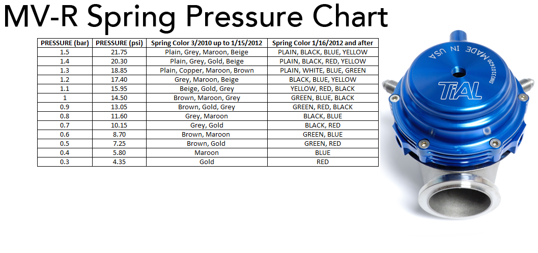

You won’t need a manual boost controller, just use the 5psi wastegate spring in the wastegate to control boost. A Tial 38mm is a good wastegate option, and they have a large variety of wastegate springs available. I don’t know if the have one that is exactly 5psi, but they have a spring somewhere around there. So no need for a boost controller. If you go up to 8psi of boost then just change the wastegate spring. It’s real easy to change a wastegate spring with an Allen wrench.

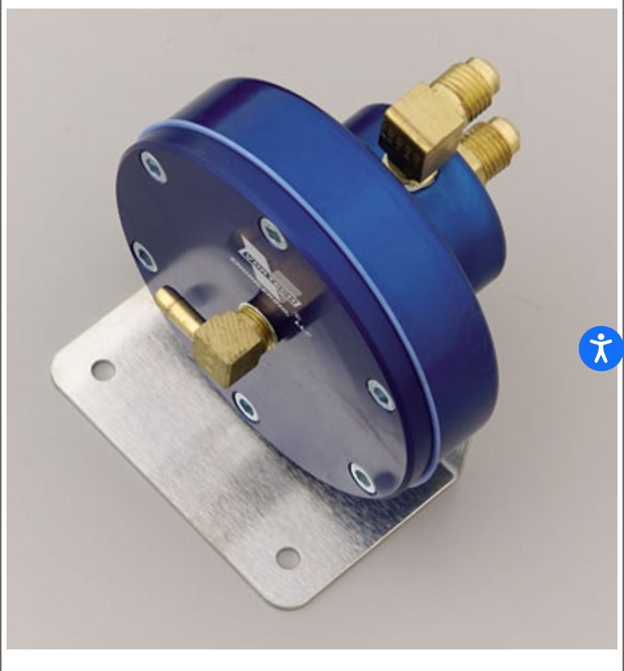

I think the engine can handle it. I just don’t know what to tune for the extra fuel with because all the tuning software I know of requires a manual transmission except for the Apexi AFC, which usually handles up to 440cc/minute injectors on a stock computer.
If I were you, and what I did, was use the stock fuel injectors and computer with the Vortec 10:1 rate Fuel Management Unit (FMU), and the Walbro 255 liter per hour fuel pump (the one rated for high pressure is better for this application).
The engine itself should be able to handle the power.
For the wastegate, does it have a name brand in it? If not, it might be a Tial 38mm replica/copy, there are a lot of copies out there. Some work fine actually. If it is a copy, then the Tial wastegate springs might work and might be the same. This goes for Tial wastegates, but yours may be the same if it looks like this externally. And if you get the right spring, then you don’t need the manual boost controller. Manual boost controllers are only for increasing the boost.

That wastegate picture is for the MV-R, but you might have the MV-S copy or similar type. Just search the wastegate you have and spring types/colors.
