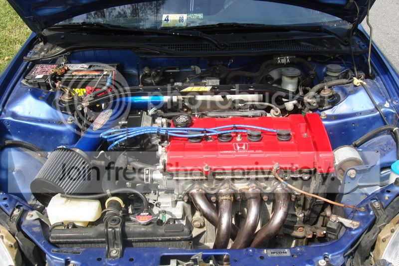

Here's a better shot of my engine.

280-300 on on 10 psi is going to be hard. to put it in prespective of going the used qualtiy route
i bought a used drag kit with hondata s200 and rc550 injectors for 1200
walbro pump, oil restrictor, 2 slim fans, boost controller, and other odds and ends for about 250
and tuning was about 400
i already had a clutch and flywheel to put in so that was free
and a blox manifold for free.
so total was 1850
with 16psi it netted me 290 hp on a t3t4 57 trim turbo.
10psi will give you about 240hp
my best advice is save up some more money because boosting the right way will take unexpected money when buying a used kit. tuning alone can cost more than a grand
hondata 300 plus 150install
300-400 tune
injectors 300
pump 100

p75 should be the correct ecu. i am guessing that you have an obd1 ecu.
like i said before, just because the dizzy is obd2, does not mean that the car is obd2. the ONLY difference between an obd1 and obd2 dizzy is the shape of the plug. on one of my cars, i have an obd2 dizzy, but i am still running an obd1 ecu.
what probably happened is that the person that swapped your car likely used the obd2 LS integra harness, which plugs directly in to your obd1 del sol engine bay harness at the shock towers. that would be why you have obd2 dizzy plugs.
