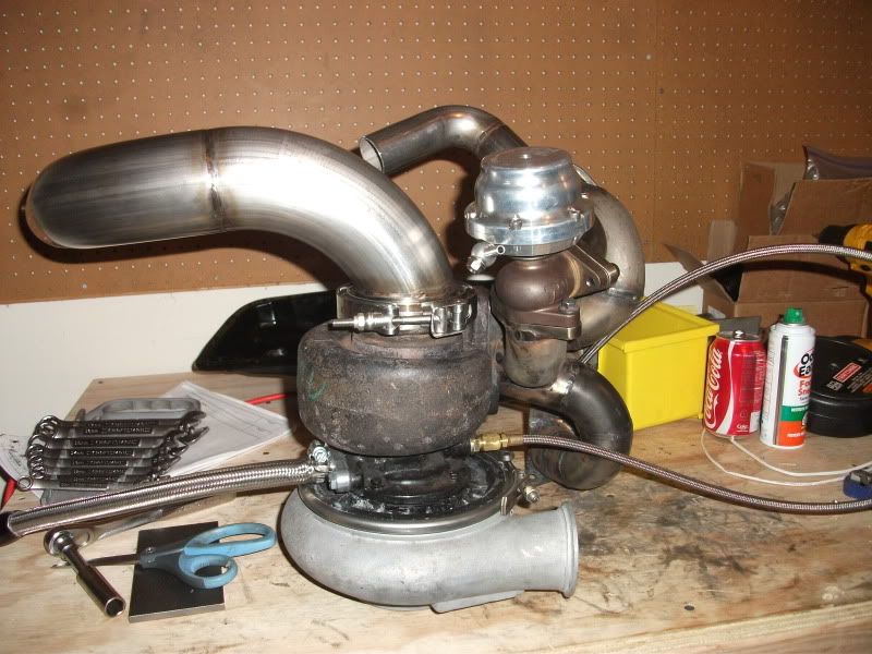

Would this design work decent on a 50 trim looking for mid 300HP on a 1.8l?
Im only asking because I haven't seen much like this and it looks to be built well and is very affordable.

depends on what it's made out of. if it's a thick 304 or better stainless, sure, my only concern is the WG placement forces a half rad and the design doesn't have any advantage that i can see over an iron log

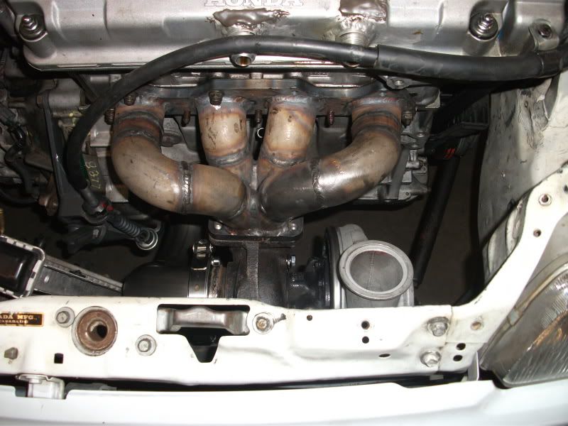

I went with this style.
It produced these results.
Virtually no creep.

Car currently has a half rad, so that shouldn't be an issue. I agree it doesn't offer a whole lot over a log other than it does offer a direction for the flow and has somewhat of a collector.

A friend and I cut and tacked it together. Then I took it to a welder. The total cost was very reasonable.

Is there anything different you would have done?

If not, SLS and Spoolin' performance will do 300whp like its nothing. Even the Schedule 10 "log" manifolds will do just fine for 300whp. I like the SLS "equal length shorty" that you originally showed here, but it does put the turbo very low relative to the oil pan for a proper return line.

Designwise, no. It makes the power and holds boost with no creep. Executionwise, I would recommend a very good chop saw or plasma cutter. The more accurate cuts will produce a better looking manifold.

I have a fullblown manifold
here are some pictures i've collected
Spoolin quick4
sls
speedfactory
I had fullblown motorsports make mine
Yes, mac is right about the oil line being low.
My fab guy told me that would be one of the things I'd have to sacrafice if i wanted a mini-ram over a full-ram manifold design. I paid $500 for mine.

But i always thought it wasn't all that worth it because the runners don't merge together.
To me it looks like an overpriced log manifold.
with that said, the deign works find for 300hp, heck even cast ebay manifold have been used on +300whp setups.
However, when getting a better flowing manifold you uncork free whp.

The speed factory certainly looks to have the smoothest and direct transition into the turbo inlet, but also looks to be the lowest hanging of the bunch. Has anyone come up with a decent drain route for the shortys??

Yeah I realize a cast manifold would be sufficient, but not likely the most efficient route. IMO (which is very light) the runner routing the exhaust into the turbo is reason enough to go with the mini/log setup over a straight log where exhaust gasses will be opposing.

I haven't talked to him for over a year. He's in SD and use to work for SLS , his name is Matt.
he actually made those picture #2-3.
