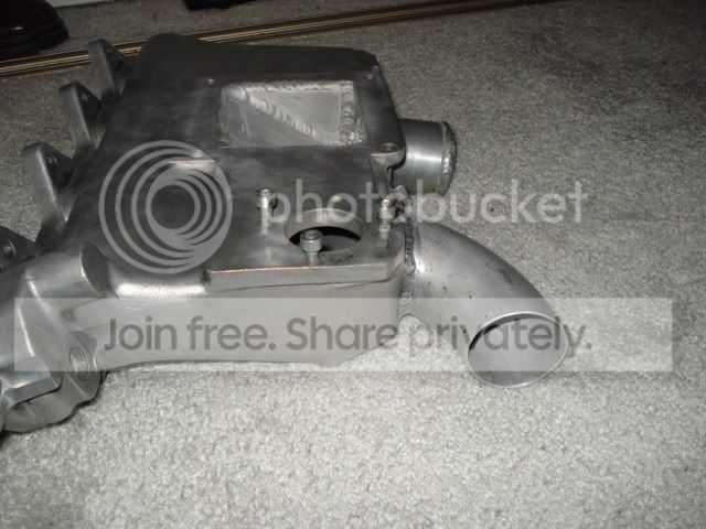

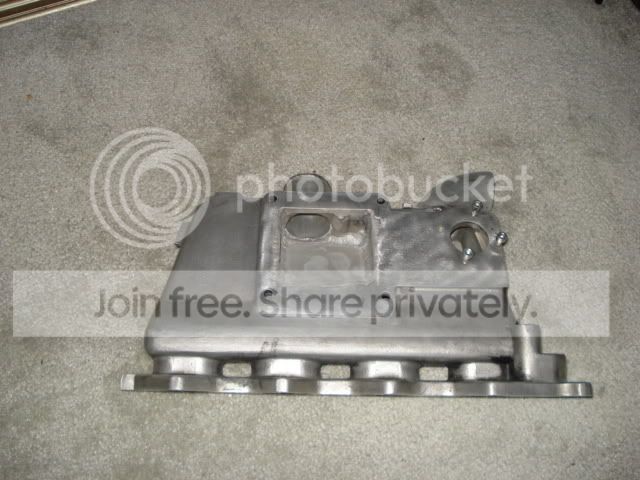

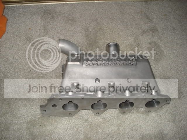

it looks like its modified for a air/air intercooler like a FMIC or TMIC. kinda funky. ill try and take some pictures tonight.

Wow, that's unique.
Since I don't have a turbo I'm not sure how exactly a blowoff valve works. what you need is a valve that is open under vacuum and closed under no vacuum/pressure. If that is what a BOV does then yes you can use it on the charge piping and put a blockoff plate on that round hole that you have with the three bolts in there.
Otherwise, get a bypass valve and that will bolt up to that hole. Note if you block off the hole here, you'll also need to block off the corresponding hole on the supercharger, since the bypass valve recirculates the excess air back into the intake tract pre-blower.
Personally though, I would just get the bypass valve. Having a BOV open to the atmosphere may cause weird issues with air getting in/out of the charge piping that the throttle body has no control over.

The bypass is meant to bypass air 100% if needed. The BOV is just meant to bypass excess pressure - only from the bottom of the valve. You'd really have to rig it to work right. Even with a cut/weak spring, the BOV may not work right.
As for that manifold, that's a slick idea. It could have been done a little better, but for ingenuity!

subscribed cuz I want to know what that mod to the JRSC is. I'm assuming from pics and your post that it's a custom pipe to blow air from a FMIC past the manifold to cool it down. right?
