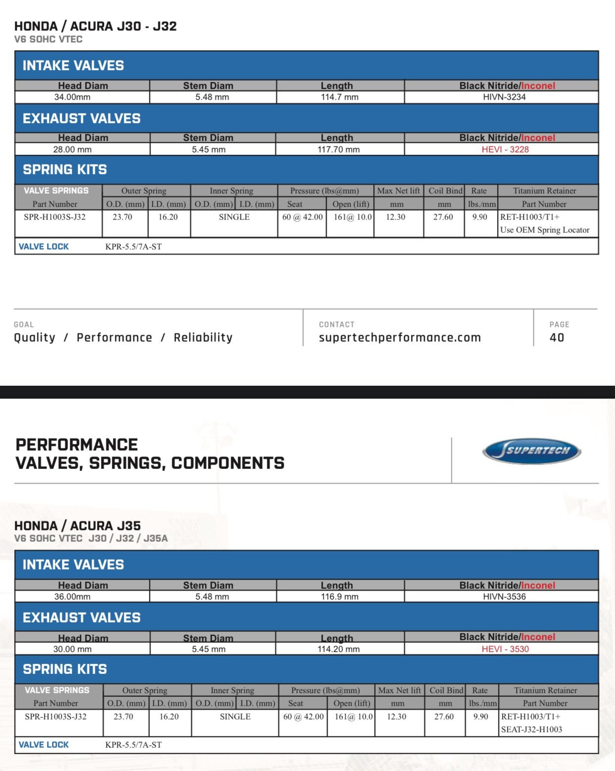

As for J series cylinder heads, I’m not aware of any being really more performance oriented than others, although maybe the Acura TL ones have the most stock HP, but I’m pretty sure as long as you get cylinder heads that fit and are compatible with your 3.5 liter block, they should/will support your goal of 400-500HP. Since you’ll have so much displacement and a turbo (or two), the cylinder head won’t really be a limiting part/bottleneck. If a 1.6 liter D series stock port cylinder head will support 400HP while turbocharged, then you should have no issue with which ever J series heads you use, as long as they are compatible with your block. As for compatibility, I’m not exactly sure if all J series heads are interchangeable, it’s something I haven’t researched. Also, pick cylinder heads with parts available if possible.
J series cylinder head parts
As you can see from Supertech Performance’s catalog, they do make some parts for the J series, but not very much. I don’t even see valve stem seals from them.
So if staying J series, you’ll be fine with whichever cylinder heads are compatible, but it might be worth it to go K24 since as you were saying there is the 4Piston K24 cylinder head available and so much more.
