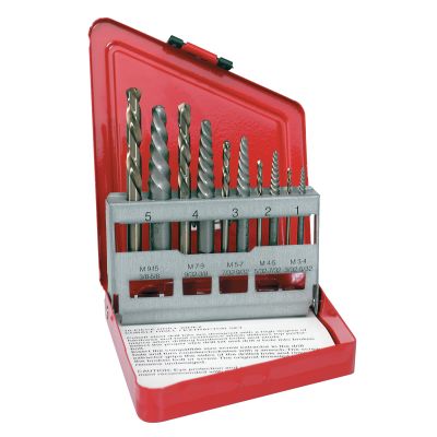

i swear by this set. it has left hand bits in case it is loose enough to walk out, and the extractors if it doesnt and needs some coaxing.

Nice set, who sells that?

yeah i got a set at the shop too. thing comes in handy quite often

i had the same problem. My oil tap snapped off twice. i got mine out with the easy out. best tool ever. go pick a set up

If you're going to use an extractor bit like those, make sure you use a T-handle, you can get them at Lowes....I made that mistake of not getting one and I snapped the extractor bit, took me 5 hrs to get the bolt with snapped extractor out
