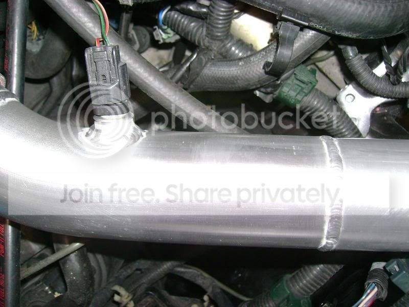

What is this and where can i get it"

You gotta make one yourself..hah

Honda also has threaded style IAT sensors on some models. find one of those and a nut that fits the threads @ your local Ace hardware and weld it to your charge piping. Extend wiring as needed. Done.

how did they thread that sensor in the pic

just get aluminum rod and drill and tap it, or you can convert to older style to put it in the intake manifold.

I have no idea what sensor that is, it appears to be an OBDII push in style like the 99-00 Civic uses and could be retained by a circlip but its hard to tell from that picture.
Just get a CRV IAT sensor, go to the harware store and pick up the appropriate metric nut for it, have it welded to the pipe and you are done. The read the same so your ecu wont know the difference.

Not many hardware stores are going to have aluminum, metric nuts. Making a flange for a 2 bolt obd1 IAT is much more feasable and chaper than buying a tap for the average honda kid. the one in the first picture looks ghetto, dont copy that haha
