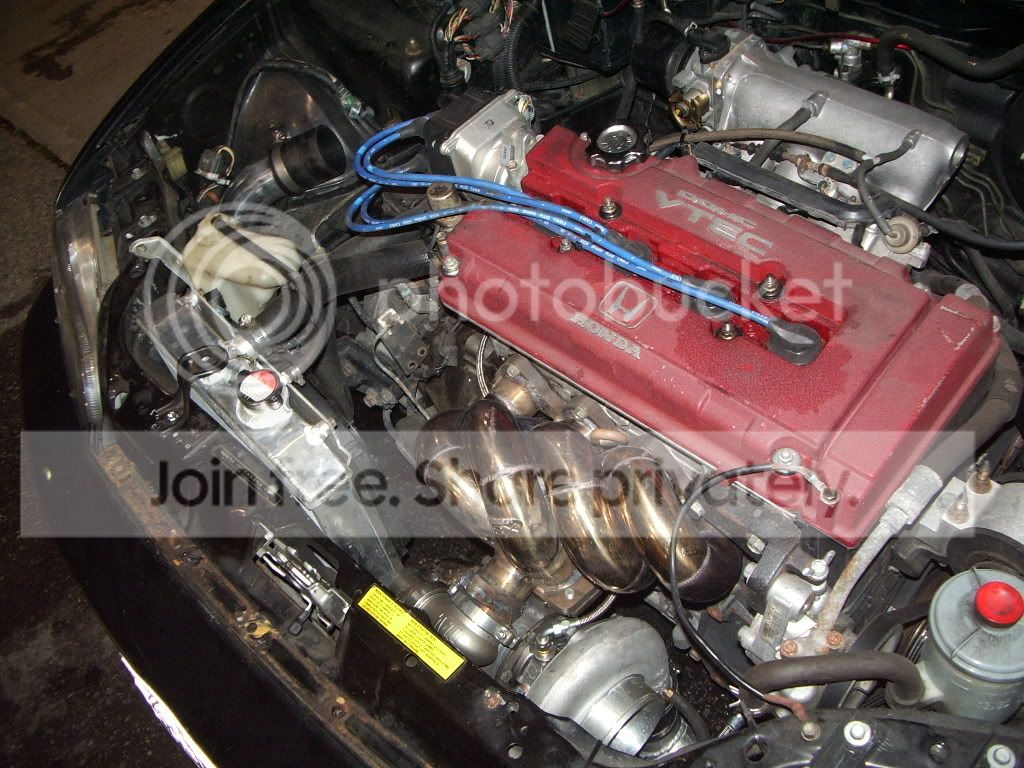

ok everything is on the car and i have a couple pics i took this afternoon, the oil and water lines werent hooked up at the time but anyways can someone tell me how to upload them onto here?

Just a recommendation: move the ground strap on your v/c away from the manifold, and do you have a map sensor plugged in/hooked up anywhere?

thanks i will loosen up the nut on the vc and swing the wire around a bit to avoid the manifold..
i am running a stock map sensor.
