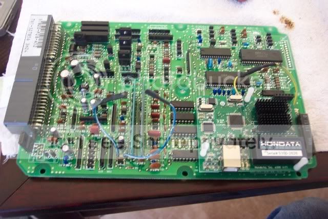

That is super easy to fix. just jump the circuit. j1 needs to be cut in order to install and have the s300 unit working. They probable started the job, didn't finish it for whatever reason and forgot to put things back to normal.
Is that all they touched? Hows j12 look?
Its easy and will take you a few minutes to fix.

<TABLE WIDTH="90%" CELLSPACING=0 CELLPADDING=0 ALIGN=CENTER><TR><TD>Quote, originally posted by mtber &raquo;</TD></TR><TR><TD CLASS="quote">Incorrect
EDIT:OOPS i had them backwards, which would mean you need to check out j12. its the blue set in my picture.....
j1 for stock/j12 for s300
Hmm i thought thats how it worked. When i socketed my ecu, I made jumper wires so i can disconnect and reconect j1 and j12. was told j12 to run s300 and disconnect j1 and j1 to run stock map and disconect j12. or was it the other way, id have to check to see how i left it

<TABLE WIDTH="90%" CELLSPACING=0 CELLPADDING=0 ALIGN=CENTER><TR><TD>Quote, originally posted by mitsuman &raquo;</TD></TR><TR><TD CLASS="quote">
Modified by mitsuman at 1:08 AM 6/30/2007
Modified by mitsuman at 1:11 AM 6/30/2007</TD></TR></TABLE>
j12 has nothing to do with your maping
j12 is removed to allow hondata to properly datalog
j1 is the only jumper needed in order for the ecu to function with the hondata s300 system.
All of this data is clearly on hondata's instructions.
All of this data is clearly on hondata's instructions.</TD></TR></TABLE>
J12 is gone on both of my ECUs like it should be. I don't really get why the guys at Hondata would cut my J1, especially if there was no need for it. I mean, I put it on my car and tried to drive it and everything, if I didn't have a wideband I probably would have ruined the engine.
Good news is that it's a quick fix and I have someone who can fix it for me without a problem. Thanks for the info guys, it has been much appreciated.
