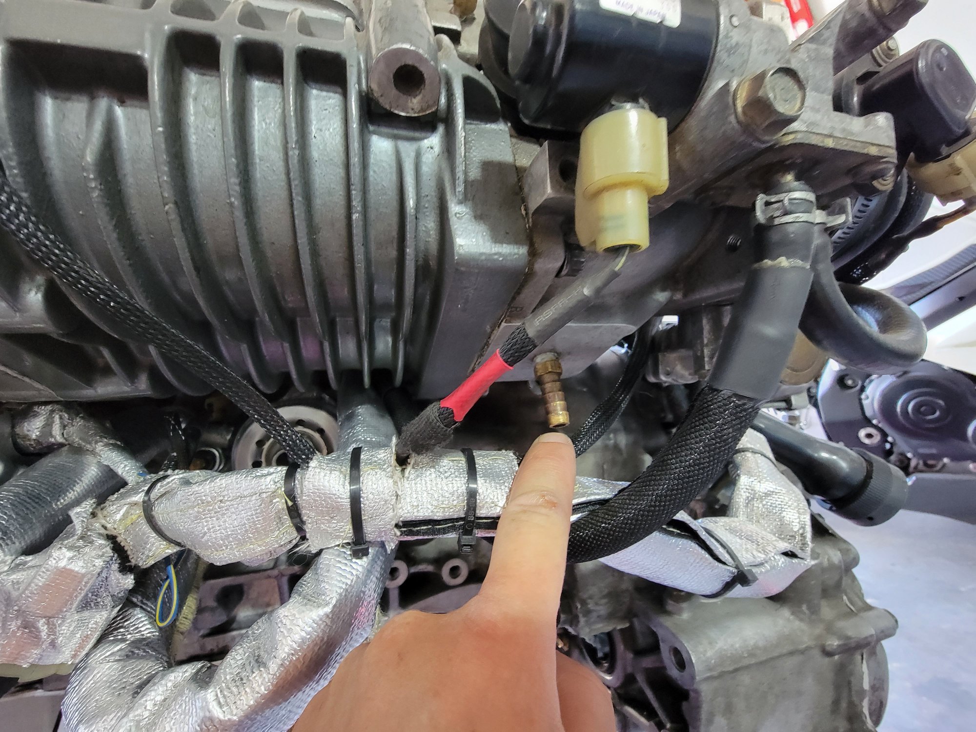

Where or what do you plug this lower port on the jrsc to?

I'm pretty sure it can be capped! looks like a vacuum source. Haven't had my JRSC in years but I'm pretty sure it can be capped off!

The barb pictured is the port for the PCV valve hose on the "B" series JRSC kits... on a stock intake manifold, the barb for the PCV valve is located on the front of the plenum... basically centered facing the valve cover.
