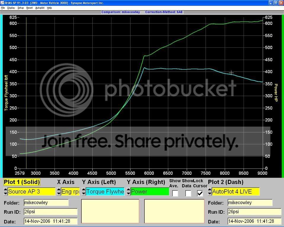

gt35r .82
if u look at my graph mine is roughly the same as above said 200whp by 5k and then up from there. power is still rising at 9k even with boost dropping off from 26 to 24psi. gonna do a little more tuning from 9-9500 and see where it goes
