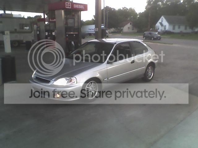

-99 EK hatch full interior, bald BFG's at 10psi
-GSR motor with pistons, rods and CTR intake cam
-T3/T4 57 trim at 15psi, street tuned on E85 by Consummate tuning
Fastest time at Rock Falls raceway in WI
R/T: .399
60: 2.029
330: 5.476
1/8: 8.072
MPH: 95.83
1000: 10.269
1/4: 12.089
MPH: 124.79
overall I was happy with my time and hopefuly next time ill be on some slicks to get those 60 foot times down and dip into 11's.

how much power are you making

I havnt been on the dyno yet but im guessing 350whp +

what size injectors?

RC 750cc at about 90% duty cycle
