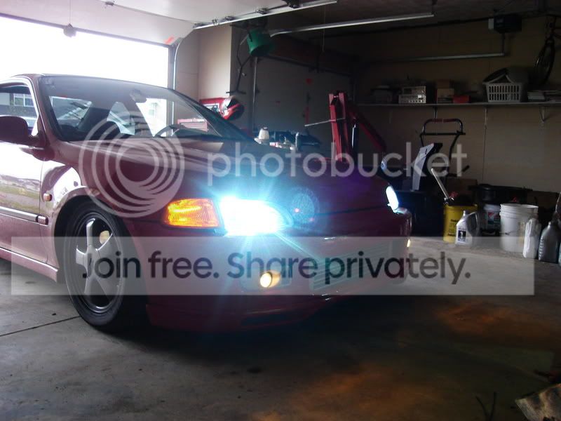

Here is my boost EJ1 that I sold last year. With JRC 8" intercooler.
Old Apr 16, 2008 | 05:23 PM
CTR_B's Avatar
Posts: 1,305
From: RayZilla, WI
Default Re: (da_dude)
What did you do to make it fit with the fogs?
<TABLE WIDTH="90%" CELLSPACING=0 CELLPADDING=0 ALIGN=CENTER><TR><TD>Quote, originally posted by da_dude &raquo;</TD></TR><TR><TD CLASS="quote">Here is my boost EJ1 that I sold last year. With JRC 8" intercooler.
Old Apr 16, 2008 | 07:20 PM
da_dude's Avatar
Posts: 1,656
From: Maplewood, MN
^ Just make sure your intercooler inlet and outlet are on the bottom of the intercooler. Than just route the IC piping right underneath the fog light.

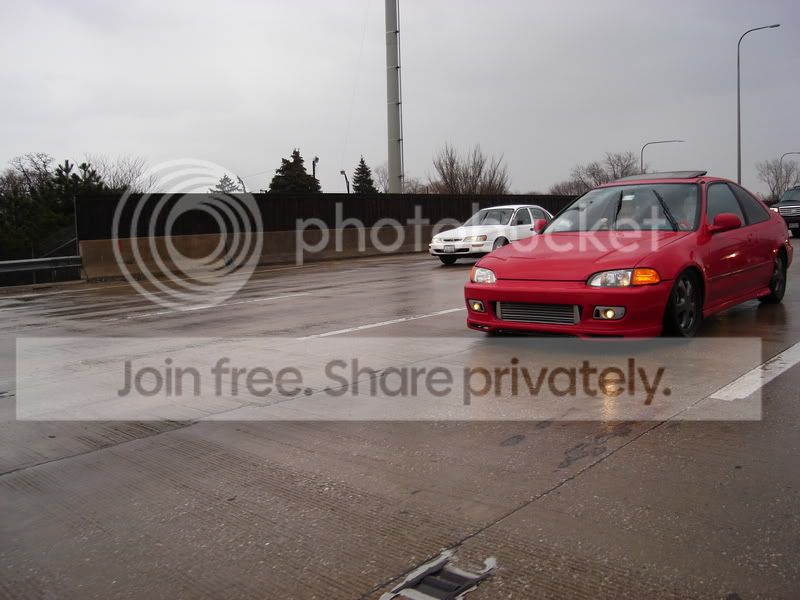

heres mine i know my intercooler is hanging low
heres my old setup with a revhard kit
Old Apr 17, 2008 | 11:35 AM
CTR_B's Avatar
Posts: 1,305
From: RayZilla, WI
Default Re: (BrothaSit)
Looks sick man, Aspecially with that lip to. This is exactly what Im hoping for.. Only time will tell lol
