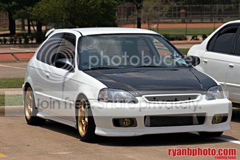

If you have a Greddy intercooler or something similar, just cut off the bottom leg on the fog light brackets. Others have discussed turning the intercooler upside down if you have a larger intercooler. This guy did a really nice job, but the windshield washer fluid reservoir needs to be relocated:
Pics were linked from this thread:
https://honda-tech.com/zerothread?id=737686&page=3

andysila's Avatar
Posts: 713
From: glendale, CA, Afghanistan
thats a clean car man

Default Re: (andysila)
<TABLE WIDTH="90%" CELLSPACING=0 CELLPADDING=0 ALIGN=CENTER><TR><TD>Quote, originally posted by andysila &raquo;</TD></TR><TR><TD CLASS="quote">thats a clean car man </TD></TR></TABLE>
Very clean, but it's not mine.

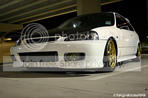

Old Dec 3, 2005 | 06:08 AM
alltech_hybrid's Avatar
Posts: 733
From: Dallas, TX, USA
Default Re: (ebp97ek)
yeah you cant either flip it or just cut the long bracket and the piping will fit perfectly under the fogs.. they still mount up fine if you just cut the bottom half. heres a pic of mine :D
