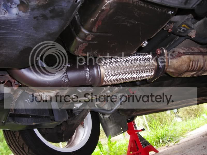

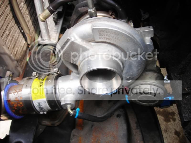

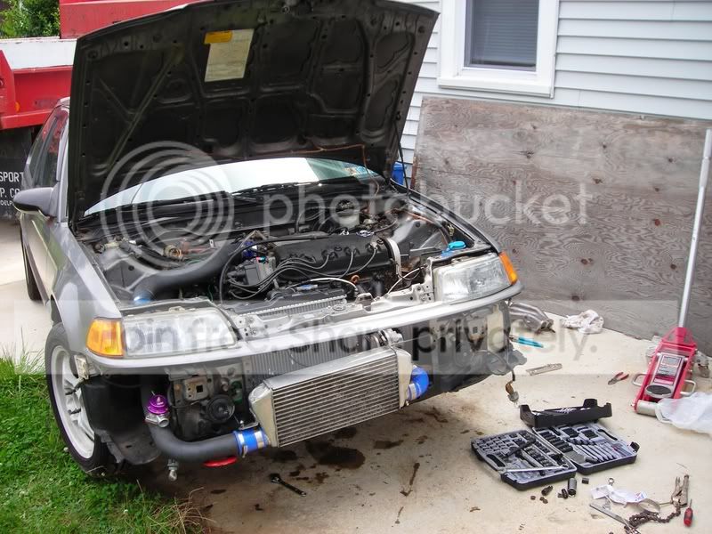

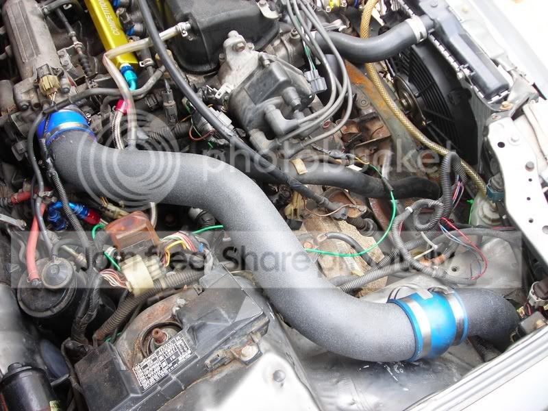

After a year of reading, researching and collecting parts I installed my homemade turbo kit this weekend without great success… Here is rundown of the parts
- TD04L WRX Turbo
- HF Manifold w/ Adapter plate
- Custom Downpipe & Charge Pipes
- Stealthmode oil lines
- Oil sandwich plate
- Knock off greddy BOV
- Modified Starion Intercooler
- Chipped P28 w/ BBKA basemap
- Innovate LC-1 (Not Installed)
- DSM 450’s w/ resistors
Here are the pics of the install:
Here are the issues I am having:
1. Upon startup the car runs very very rough and is exhausting a dark color smoke. At first I thought it was some of the paint and other BS burning off but after not calming down in a couple minutes I am led to believe it is something else…
After a little reading I am led to believe that maybe the turbo is getting too much oil and blowing past the seals. If this were the case wouldn’t there be oil in the charge pipes? (There isn’t…) The oil is fed from the sandwich plate and uses a -3 AN line, does it need to be restricted?
2. On my blow off valve, it has two nipples for a vacuum line, which one should the line be plumbed to?
3. What to do about the crank case vent. I know ideally a catch can should be installed, however I don’t yet have one. For now should I just run a breather filter on the VC and plug the piping? When I first ran the car I had forgotten to disconnect the VC tubing, could this attribute to issue #1?
Thanks in advance for all the help
Also i am aware that the intercooler is not level, the brackets for it broke during install

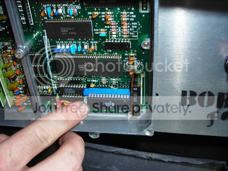

Also i think i have discovered what is causing my motor to run erratically: A backwards EPROM in the ECU, thus not running the map for the dsm 450's

Also i think i have discovered what is causing my motor to run erratically: A backwards EPROM in the ECU, thus not running the map for the dsm 450's</TD></TR></TABLE>
Yeap, that is what I was going to point out to you too but seem like honda-tech is having some down time. Flip it around and it should be good.
it's to improve response on certain setups. for what you are doing just hook up the big one to manifold vac/boost with a nice thick line and it will be fine.
and ya, put the chip in right!

I flipped the chip, fixed the valve cover vent, and tightened the hoses all around. I then attempted to start the car. I would put the ignition to on, and wait for the check engine light to go off. Thus confirming that the ecu is working properly, (with the chip backwards the light never went off).
The motor would crank but did not seem to be firing. I checked all the fuses, none blown. I then checked the spark plugs and found they were a little fouled. I then cleaned them up and still no change. I tested for spark by grounding with a screwdriver to the chassis. No visible sparks. I then ran out of light and have to give up on it for now. Any suggestions?
I also tried a similarily configured basemap, still nothing.

i think when u put the chips in backwards they may erase so that could be the culprit... reburn a chip put it in the correct way ...notch toward the latch

I am going to try again. But i have already burned a new map the correct way, still just cranking...

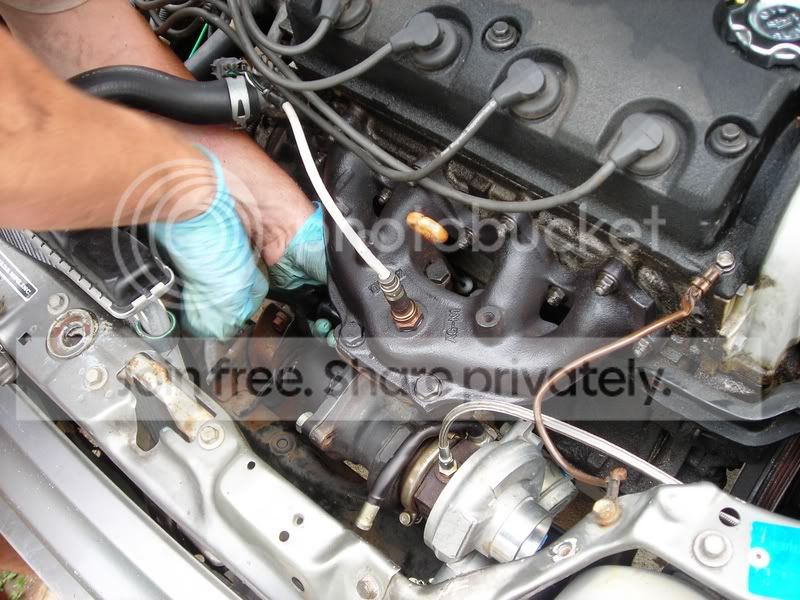

Also what is that sensor sticking straight down into your turbo? Is that your primary 02 sensor or the wideband sensor? If it is you can't place it there it needs to be downstream of the turbo about 16-18 inchs away on the downpipe. Sensor will get roasted very quickly up there, if it's your primary 02 sensor that might also be your cranking problem.
Old Aug 28, 2007 | 04:15 AM
Chronicsinners's Avatar
Joined: Sep 2001
Posts: 6,045
Default Re: (DCxMagus)
<TABLE WIDTH="90%" CELLSPACING=0 CELLPADDING=0 ALIGN=CENTER><TR><TD>Quote, originally posted by DCxMagus &raquo;</TD></TR><TR><TD CLASS="quote">swap the ECU with a known good ECU might be a bad ecu.
Ok. It is the primary o2 sensor...I will relocate the sensor this afternoon...

that sensor is probably fried and that also probably the cause of your car not starting
Relocate it and if it causes too much problems you might need to get a new one

a o2 sensor is not your problem your not getting spark you need to check your wiring you probly didnt wire it right make sure you got the ignitor wire rite.
a rom in a ecu backwards does not erase it and wont ruin the ecu.

the nbo2 sensor location is fine....ive run mine like that for along time...
Thank God
The car was a running d15b running a p28 basemap for 3 years prior to the turbo install. However it is the first startup with the dsm 450s. I used inline resistors, (my soldering work was legit)

I just looked at the pics, not saying this is your problem but you might want to relocate that 02 sensor.

Ideally yes, however i dont think it has to do with the not-starting problem
