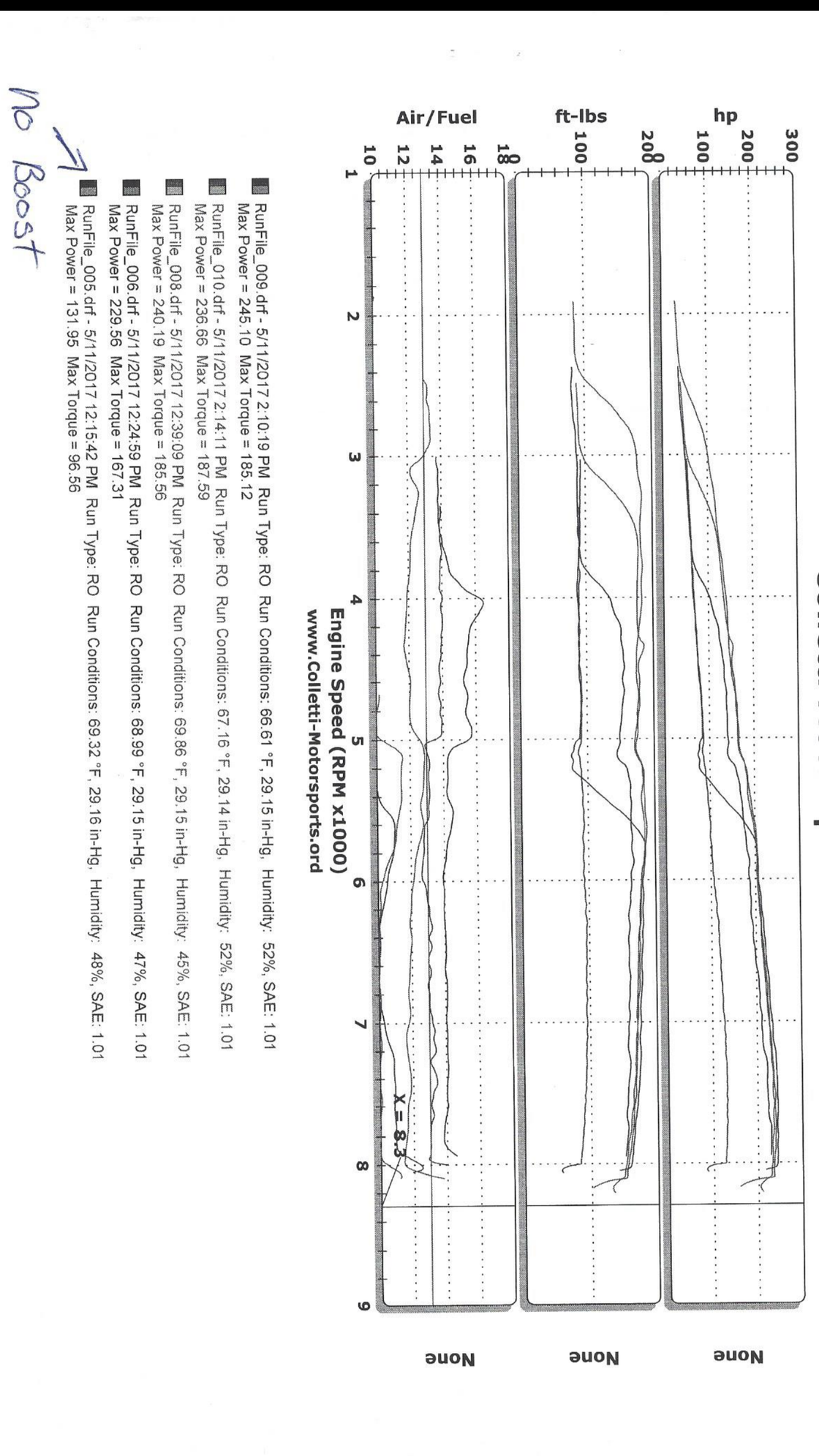

Hey guys!
Full disclosure, I'm the owner of Eturbo. That said, I ran my third prototype on the dyno which delivered very promising results and I wanted to get your input on the power this is making. More importantly, I wanted to get your thoughts on the torque section.

any chance you can post a picture of said product?
I'm also very curious how you're maintaining a fairly consistent boost pressure.
also curious how you didn't blow it up running that lean, or in the least how you didn't get crazy misfires.
what motor is this on?
I ask all of these questions, because those torque curves look way too good, too good to be true considering everything else I see that I'm inquiring about

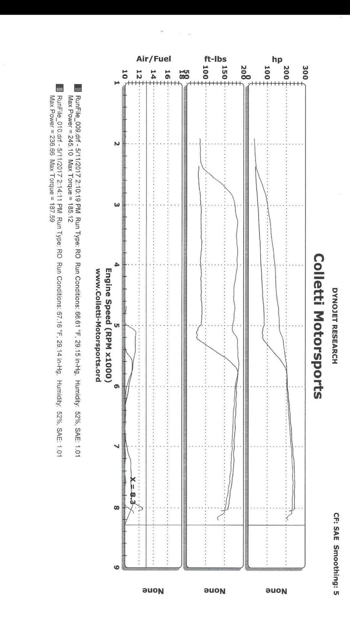

Edit: this is on a B16A3 with supporting mods.
Edit 2: Oh I see what you mean about the car running lean. These where runs during while we were tuning. It isn't that lean anymore lolol
Here is a pic of the Dyno of two eturbo runs being triggered at separate points in the RPM band:
I have videos and explanations on my facebook page but I've been dinged before by admins for self promotion. Here is a pic of the setup and a YouTube video of the run

how is it regulating boost level?
Old May 15, 2017 | 03:37 PM
teknicalissue's Avatar
Joined: Aug 2010
Posts: 97
Default re: Eturbo's before and after dynamometer plots using a B16A3 Engine
via the electric motor. I can change boost by regulator motor power output
