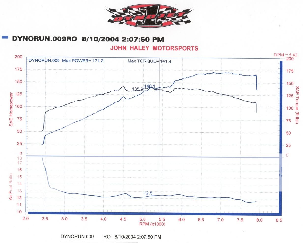

Did your chart look anything like this...?
just an example chart but I'm guessing yours might look like this..
This is a fine examlpe of falling flap on it face....

Default Re: Dyno Not so good (CivicEJ1)
yeah something like that but lower numbers. I just dont get it.
