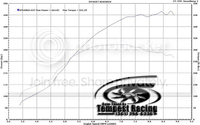

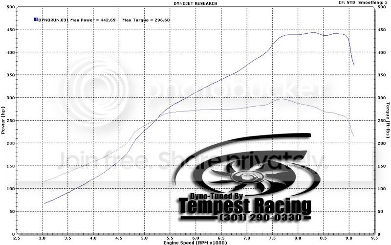

distributor didnt work right off the bat. changed it out with another and everything was good to go. boost and chart were wavy at first...found boost leak internal on throttlebody. fixed that.
car made a little over 400 whp at 20lbs. wasnt too happy....car just seemed like it needed bigger cams. i made some cam gear adjustments and re-synced ignition timing. picked up 35whp. dialing in ignitoin timing at the same boost level picked up nearly another 20.
car has no so awesome tires, doing pulls in 3rd gear started to develop some wheel spin once we got up in power.
will probably run the car in the 350-400whp range for daily driving. i have done several cars lately in the 450-475 range on pump that havnt had any reliability problems, however i do suggest keeping it around 400. nobody listens though
customers original power goals were 450whp. car should be a blast to drive.

OMG! 465!! I thought u said 457 on the phone. This is even better! Damn it Joe, why are you so good!! Since you made this engine great from the inside/out, now Jeff has to show off his talent with the valve cover, no pressure Jeff

only 400whp on 20psi on a gt35? man. i have at3/t4 60 trim with .63 stg 3 wheel an people say i can get 400whp out of that. is that true?

i would think a gt35 would have made more power at less boost on that motor.
i made 400 on a built ls SC61 on 19psi
i guess my 10:1's are no good then huh tony

kinda looks similar to my power curve Joe. I bet he can't get traction for *****.

no difference in lag with low compression, just slightly less power off boost. 35r on an 84mm doesnt have that problem. as you see in the charts peak boost is reached at 5500-6000 rpm or so, but if you hit the gas at 3k the car still has *****. i really like 35r's on street cars.

so another 70 horsepower with 1 lb of boost isnt good? i think with a set of cams we could get the car into the 450 range with a few less lbs of boost. a throttlebody wouldnt be a bad idea either.
<TABLE WIDTH="90%" CELLSPACING=0 CELLPADDING=0 ALIGN=CENTER><TR><TD>Quote, originally posted by sc4dr &raquo;</TD></TR><TR><TD CLASS="quote">kinda looks similar to my power curve Joe. I bet he can't get traction for *****.</TD></TR></TABLE>
if it wont hook on the dyno, it surely wont hook on the street!! the car will probably be faster in the 15lb of boost range. the cars still strapped on the dyno right now, we are using s300 for boost controll so i'll set it up with differnt boost in each gear which should help.
