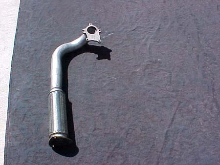

Alright guys i'm ending the near of the road for my turbo setup & the last thing i need is a downpipe, this being one of the harder things to chase down. Well browsing around ebay for the past month or so i've been seeing alot of (dare i say it ?) SSAutochrome downpipes for about 120 or so shipped which isn't to bad for a new downpipe but me keeping in mind it is SSAutochrome & they don't exactly have the best track record, but i guess my question is ...
is there really anyways they could mess up making a downpipe ? ...
would you run the downpipe ? ...
my girlfriends willing to buy it so it's not really a loss out of my wallet but i'm just wondering if it's worth the hassle or not cause for right now i'm leaning towards trying it out ...
here's the info ...
http://cgi.ebay.com/ebaymotors...75373
- Thanks Justin

a downpipe really needs to be custom made for whatever manifold you are using

yeah i don't think that dp is gonna work for your manifold. that dp is most likely for SSAC's ramhorn manifold. you're gonna have to cut and reweld to make it work for your setup. you should've just PM'd someone to fab one up for you. hulkhb just made dp with an ecutout for a drag manifold a few weeks ago for my cousin. looked sexy as hell.

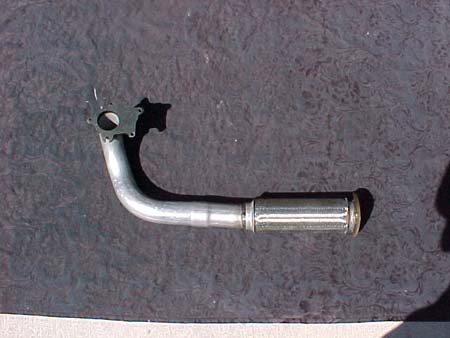

Umm have anyoner ever even see this downpipe first handed? I ordered one a few years ago and it mild steel, doesnt look half bad for what costed 60 buck, the downpipe is a 2 piece. It a slip on fit at the bump you see in the middle of the downpipe, i for one like ssautochrome downpipe.
BTW, the piping is only 2.5 inch not 3 inch, the flex pipe however is 3 inch i believe

That DP isn't going to fit... Good luck trying to make it fit.

Plus why are you buying a SS auto crap DP? For a little more you could buy a OBX DP that's modeled off the full race DP!!! Or just have an exhaust shop make you one, or make it your self. If you plan on using that DP, I hope you have some fab skills, and can weld. You will probably have to cut the flange off, and make a couple of pie cuts and reweld and extra bung for wide band.

yeah regardless of the quality, most likely this dp isnt just gonna bolt up. its gonna have to be cut and rewelded. more time and money.
btw, what manifold are you running anyways?

If the way you have the turbo mounted in your engine bay is typical to the rest, the compressor inlet will be towards the passenger side and the turbine outlet will be towards the drivers side. The ssauto DP will not fit at all. Look at the picture.

I assume someone buying a downpipe would have enough brain to know which way his turbo face and which downpipe would fit instead of buying the opposite one
