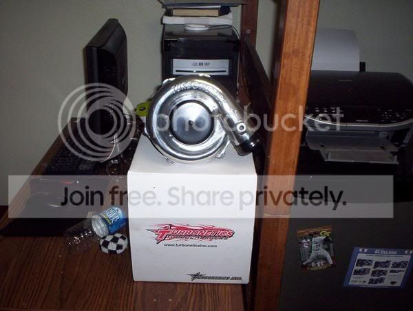

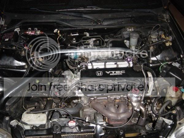

i think i did this right i have never posted pictures before. here are some pics of the turbo and the engine setup. the turbo is a turbonetics T3/T3E. he did get it tuned professionally. and i think he is running about 210whp @ 8 psi.

the WG line is disturbing. hanging near the exhaust and using a "T" for boost control
is it tuned? thats the question i'd ask first. with that "boost controller" i would think not but?
