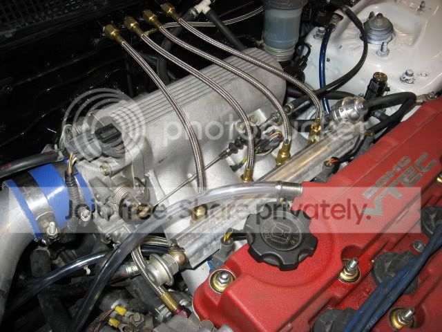

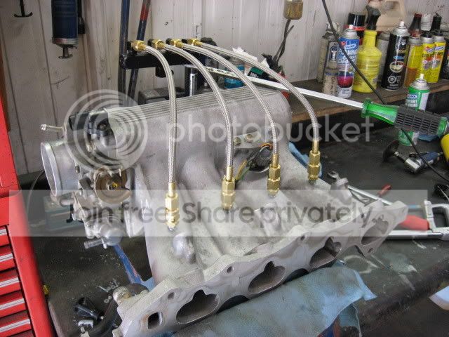

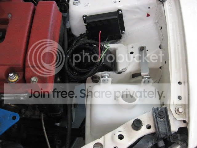

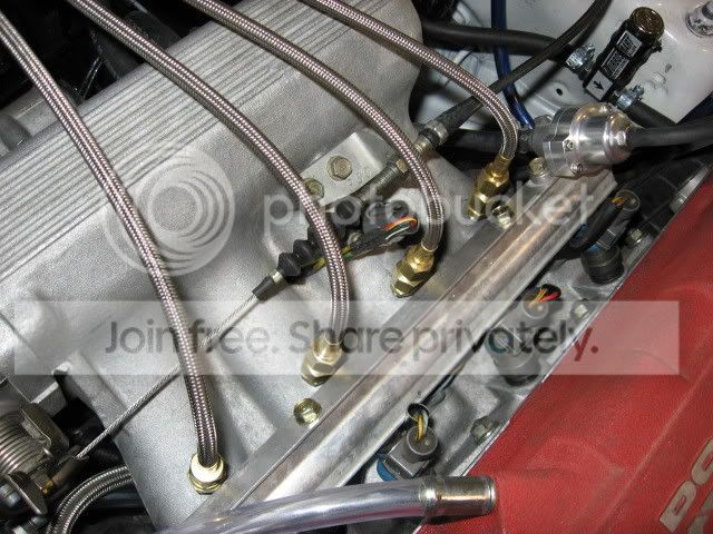

over the past few weeks i have put together a kit that my friend and i finally finished installing tonight. its made of basically a snow performance pump and controller. the lines i had to make so i can take the car to the track. they were kind of a pain to create but in the end it all worked out alright.
the only problem im having right now is figuring out what pressure to run the pump at. as you can see im going to be doing direct port injection. at the moment i have 4x100ml/min injectors. i quickly rigged the pump up to power to create a current and see just how much water it injected. IT WAS ALOT. the pump was almost turned down all the way. now mind you ill be starting at about 50/50 pure methyl hydrate/water. is this a good place to start? does anyone have some experience with this? i cant base the amount injected to anything i have seen so far so i guess ill just go conservative and see what happens.

Snow performance makes a good kit. Direct port meth is the right way to do ii! Finally, someone that is doing that right.
1cc = 1ml, so each mozzle is 100cc. If 400cc is too much meth, then I guess all the pro cars that use straight meth through 8 1600cc injectors are in trouble lol.
That should be fine as long as you're using the snow controller to activate the pump. Which snow controller are you using? The stage 2 contollers are progressive, so as long as you use one of those, you shouldn't have to worry about it. The progressive controller is the key though.... with the stage 2 snow ones, you dial in a beginning boost pressure to start injecting meth, and an ending pressure where the pump is injecting the full amount of meth. 50/50 is a good combo to start with. I ran straight meth on mine with 2 of the big snow nozzles (they're either 625 or 675, I can't remember). That much meth is not a good idea unless its direct, like you're doing.
Just be careful because most of the nozzles are not designed to be subjected to vacuum, like yours are going to be. What nozzles are you using? Are you 100% sure they're designed to be subjected to vacuum? If not, then the vacuum your engine creates cause the meth to leak past the nozzles, which is not what you want.

servion brought up a good point, those h20/meth lines might need some sort of check valve on them. Maybe just a single checkvalve before the distribution block might suffice. A valve would probably be best.
nozzle size will largely depend on what mixture you are shooting for, and power level. I think for 100%meth, your nozzles are too small, but they might work well with a 50/50 mix.

I believe checkvalve(s) won't work properly here since the jets are subject to both boost and vac after the throttle plate. A solenoid right before the distribution manifold should do the trick

"Shut off solenoid is used when mounting the injection nozzle lower than the reservoir or the reservoir is rear-mounted to prevent gravity flowing. It is also used to prevent siphoning when the injection nozzle is mounted after the throttle body or carburetor and is exposed to vacuum. "
http://www.snowperformance.net/product.php?pk=20
Like I said, I used two 625cc nozzles on mine.... it worked fine, but I wouldn't recommend that without doing what you're doing--direct port. 100cc will be easy as long as you use the snow progressive controller... just make sure you tune the car.
