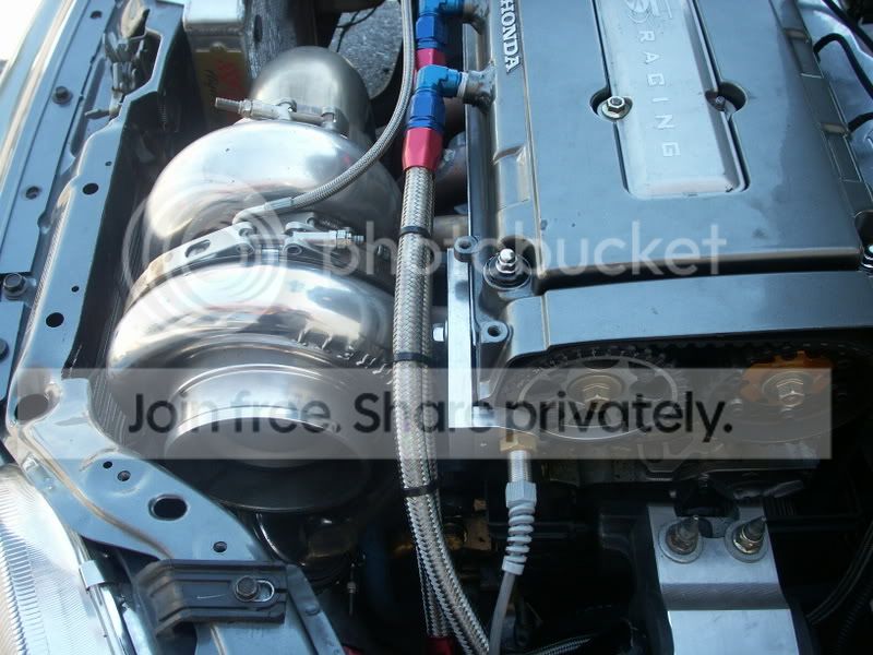

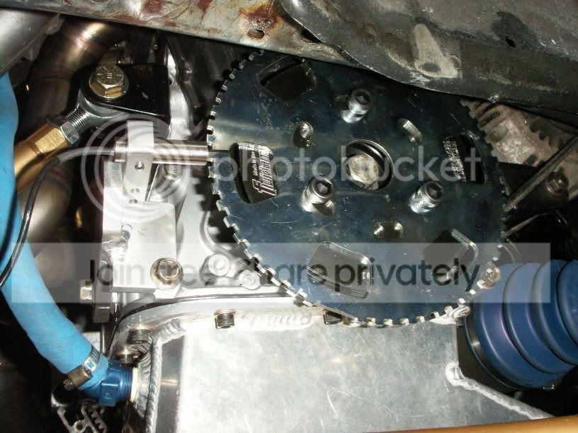

they are electromotive coils, used with TECIII. this is why i dont run the system anymore
it runs a 60-2 crank trigger, which in theory should work very well, but no matter how we mounted it, even moutning it on the inner most side of the pulley.....anything above 600whp the car would start missfiring.
here was the solution. tony's T1 Cam Trigger Kit (everybody on honda-tech should have one ) it made 2 years of my problems go away. very first pass with it on there was a 9.8 @ 152
