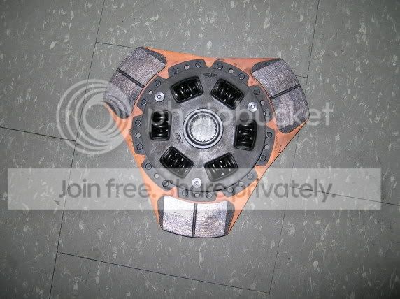

I just put an Exedy 3 pk clutch in my 1999 GSR and after about 8 hrs of work i got it together and ready to drive out. When i went to drive it, i put it in gear and let the clutch out........nothing.........it didn't move. I don't understand why it is doing this. I have clutch pedal pressure and it doesn't seem like the arm on the throwout bearing is binding because i made sure to grease it. I just don't understand what would cause this!!

wouldn't it have caught even a little bit? It didnt even so much as grind or scuff.....i have pics of it too.....
