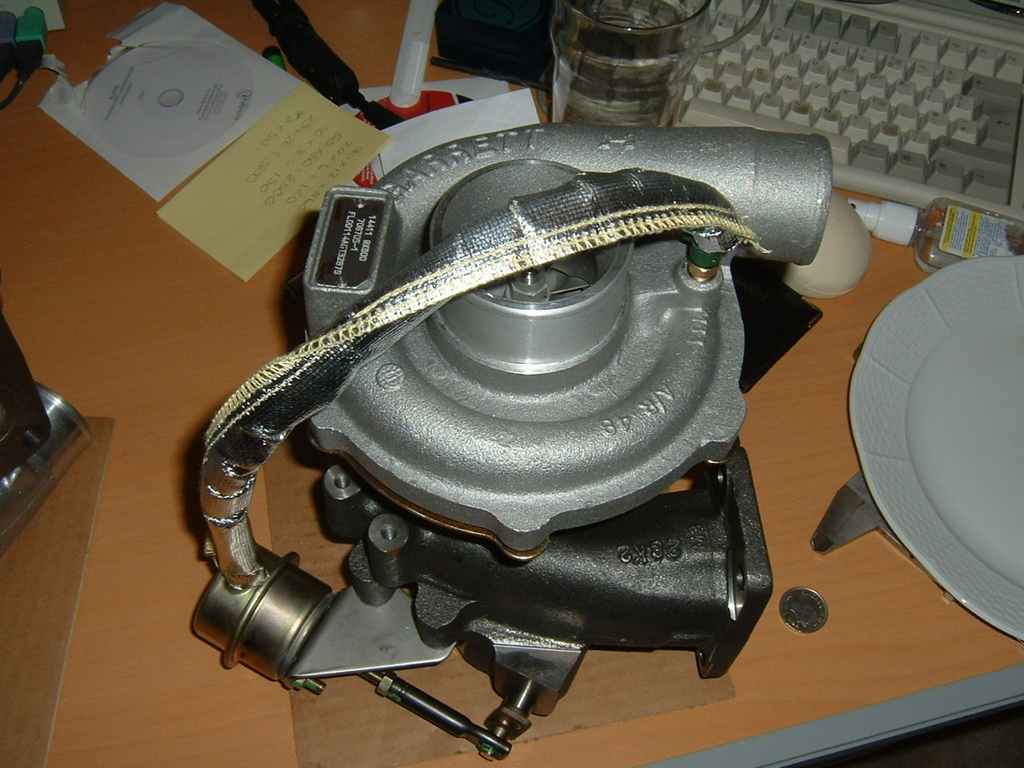

this i a garrett gt32 turbo Compressor AR .48, Turbine AR .69 My ? is this turbo can make 400+++++ at 15lbs whit LS/Vtec in top mount setup thanks

Ah, the smaller GT32s, with the 71mm wheel. Those are really good for an LS engine, but the VTEC head utilizes CFM volume so effectively, that it might not be as efficient as actually a larger turbo. 400whp by 15psi will not happen. It will make about 300whp or so at that level of pressure level.

can upgrade this turbo for hit 380hp at least ok the right ? this turbo i good or not the turbo are high in mi contry and buy another is $$$$$$$ but my hit is 400hp no more than that becuse the gas here is in 85 octane and no good for daili drive got VP fuel and is beter Sorry for My inglish
