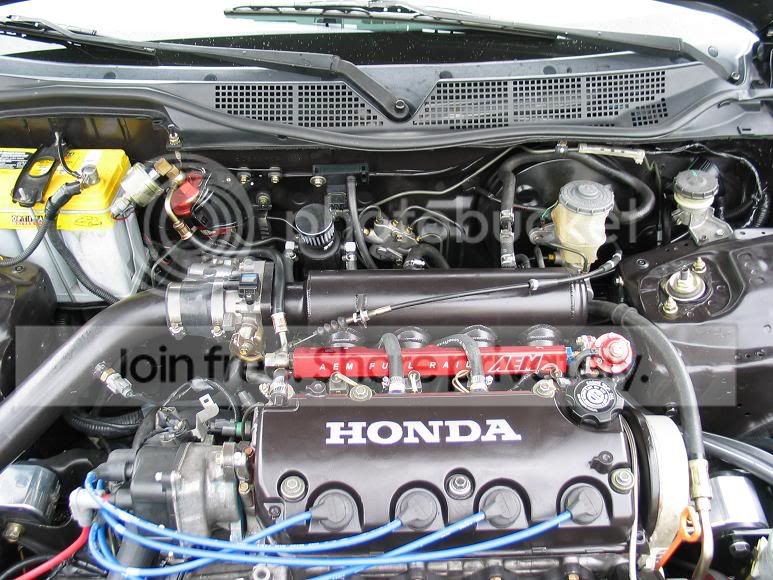

Ok, Info, Car was starting before, didn't change anything.
Battery Volts Via Gauge 12.1 on start up, I have even tryed to start it with being jumped
Car is getting fuel 44 psi via fuel gauge and i can hear the pump walbro 255
Car is getting air, via boost gauge, and it almost starts
It cranks and sometimes shots exahust to not start
Replaced, NEW DIZZY and Ign
NEW MSD BLASTER 2 COIL
Did the spark plug trick, plugs have gas on them, getting fuel, took a plug out and put it on my block, getting alot of spark.
So i'm thinking starter, I try to bump start it / push start in 2nd, NOTHING
I went down my hill and back (great workout pushing your car uphill alone)
2 people push start still nothing. Tried like 10 times.
I have replaced the main relay as well, i tryed 4 different ones, the car cranks and turns over, just won't start.

I dont have a huge amount of experience with boosted cars but this doesnt sound like a starter problem. if you're getting fuel and spark have you checked your timing? I like your valve cover btw...

The timing was marked with a marker when i changed the dizzy it was fine before, was not touched any different

You need three things to start...
CONSTANT fuel, spark and compression...
1st, take some starting fluid (or carb clean) and spray it in the throttle body (open) for 2 seconds and try to start the car. If it starts for a second and dies...you have a fuel problem.
If it doesnt start at all...you most likely have a spark problem. If sometimes the car backfires, most likely you are out of time (or cam has jumped teeth).
Lastly, check that you have compression.
If the car cranks over...the starter is not your problem.

is that a recent pic?
it sounds to me like you're not getting spark at the correct time.

Check four things:
Spark, Fuel, Timing, and Compression.
If you have all four of those things, it should at least try to run.

<TABLE WIDTH="90%" CELLSPACING=0 CELLPADDING=0 ALIGN=CENTER><TR><TD>Quote, originally posted by xenocron &raquo;</TD></TR><TR><TD CLASS="quote">most likely you are out of time (or cam has jumped teeth).
Comp should be good, motor was just rebuild a week ago, ran strong a week ago
ITs just about to turn over, like 1 second before the car starts and it just stays like that

It sounds like timing to me.
<TABLE WIDTH="90%" CELLSPACING=0 CELLPADDING=0 ALIGN=CENTER><TR><TD>Quote, originally posted by Quad-Damage &raquo;</TD></TR><TR><TD CLASS="quote">Comp should be good, motor was just rebuild a week ago, ran strong a week ago
That's a big SHOULD. You don't know what happened. Maybe something went wrong in that rebuild.

yea, sounds like timing is off.

valve stuck open? Do a compression test.

this looks like the engine in that 4 door ek in the honda-tuning mag?

you have a known good ecu? definitely worth a shot for you to test it out.

distributer is put on 180 degrees out. or the belt jumped a couple teeth.

This sounds like an issue i had a few weeks ago. I was running a customer's car at the track for him and as soon as i shifted into 2nd the car just took a ****, lost all power, and barely made it to the end of the track before cutting off. We checked everything...fuel good, spark good, compression good, cam timing good, etc. Turned out to be the rotor button in the dizzy had cracked and shifted throwing spark timing way off. It was getting spark, but apparantely not at the right time.

I just had my dizzy rebuilt by redzone and i saw him do it.

not likely. they only go on one way. someone would have had to remove the teeth that go in the cam and flipped them.
OP, you should confirm all of the other things people have been talking about. compression, timing, etc.

have you check all of your plug wires to see if they're in the right firing order?.

They are the same as my 1993 dx hatch
1,3,4,2 starting at the lower left of the distributor cap and rotating clockwise. the cylinders are numbered 4,3,2,1 left to right. right
i thought that was the case as well, but it's not

it sounds ti me that u have ur plug wires mixed, although i dont know the timing order off the top of my head.
now that i think about it,
12
34
looking at it from the passenger side frender
one being the closest to the distro and 4 the furthest, and i know its labeled the other way around.

plugs are in this order, my catch can is higher then it sits now btw
fucken autolight starter broke on me, haha ill take a pic with my cell, still wont start

got compression? Simple test take 5mins.

car wont start
&lt;embed src="http://lads.myspace.com/videos/vplayer.swf" flashvars="m=22526188&v=2&type=video" type="application/x-shockwave-flash" width="430" height="346"&gt;&lt;/embed&gt;
Add to My Profile | More Videos
IT"S SO CLOSE TO STARTING
nice!
GOOD THING i had a spare y8 starter
I wish i could fix it without towing it to a shop, i need to buy a comp tester, I'm taking everyone ideas in as well
