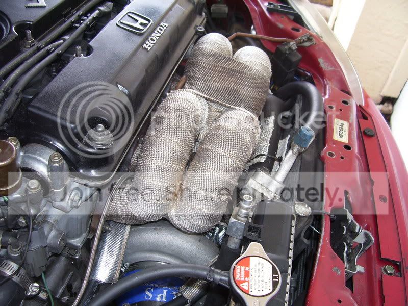

I am running the Neukin A/C ramhorn manifold with a T67/T3 bb turbo. The turbo I am running is one of the biggest t3 back turbos. The fit is tight as hell. The fan will have to go on the front of the condenser. Get Thermo-Tec heat sleeve for the A/C lines. Any turbo smaller than the t67/t3 a.k.a Full-Race should fit with no problem.
I think it was $750 or less for the manifold with a tial 44mm flange.

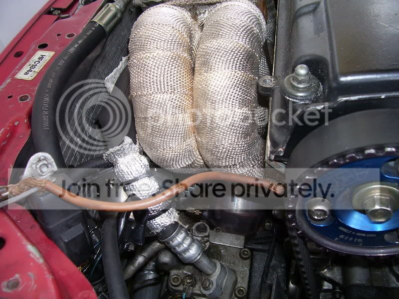

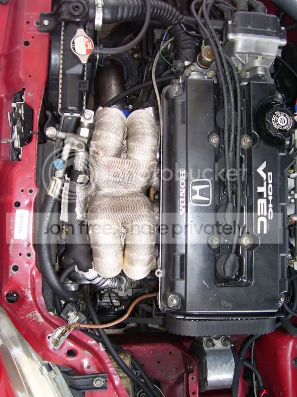

ProjectDC2: The turbo looks snugg and really close to the block...did you have to shave the block at all?
I wonder if a sohc in a civic has more clearance in the front compared to bseries.
Btw ..what is running the oil lines like? Any pictures of you running the oil drain and feed line on the turbo and installed in the engine bay?
EDIT: More curious of seeing a 96-00 Civic with Bseries not sohc...not that i have anything against sohc's
