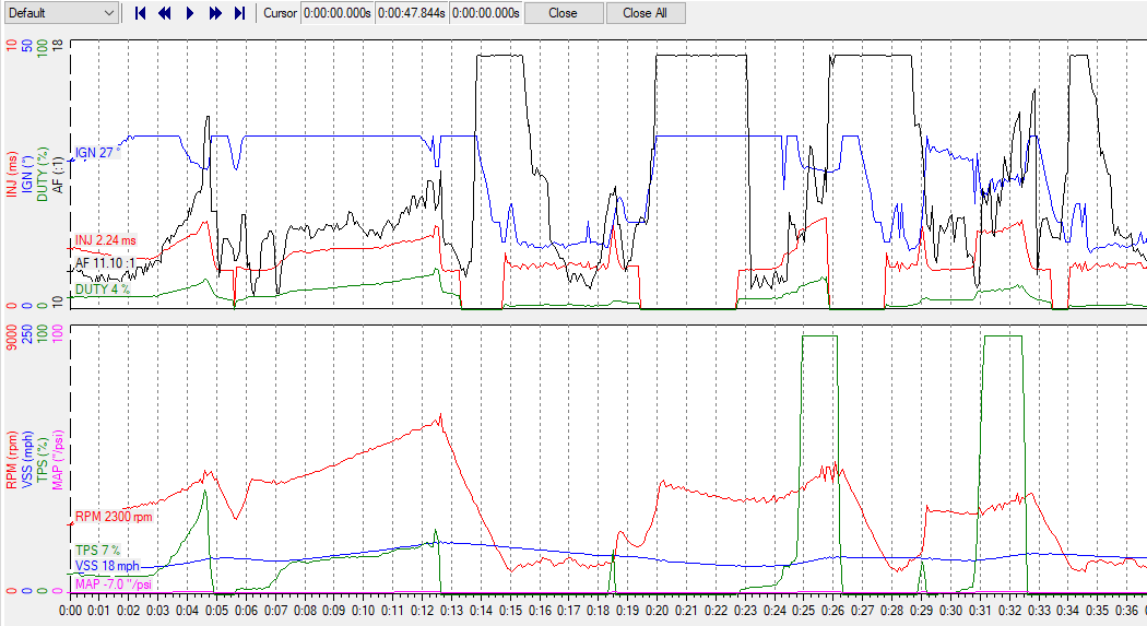

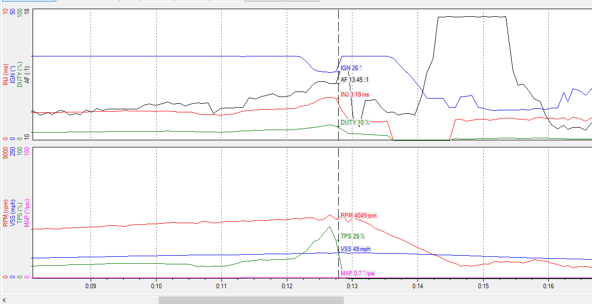

Alright! I'm back with some datalogging. I've attached a screenshot of one of the logs, along with the file itself. As soon as the car sees .01+ Map pressure it cuts. You can see the AFR go way lean. I also have a new code, #9 CYL - not sure what it means but it seems like more distributor issues.
There are two logs attached. One attempting full throttle with pretty aggressive cuts, and one with a very gradual throttle and what looks like a small cut. I do see slightly more map pressure on the gradual throttle datalog. I also attached a datalog file with just revving - no load on the engine.
Download the datalog files here: https://drive.google.com/drive/folde...xZ?usp=sharing
Full throttle pull.
Light throttle pull

From what I see, it appears your MAP sensor is kaput. Looks like you're getting noooo reading at all from that dude. Homeboy is flatlined like a champ in these pulls.

Ahh! Can’t believe I didn’t see that.. must’ve been too focused on fuel... but what!? I’ve re-pinned, confirmed pinout and continuity, plus changed the map sensor. Let me look over the logs. Can someone confirm Map pinout numbers on P28 ECU?
