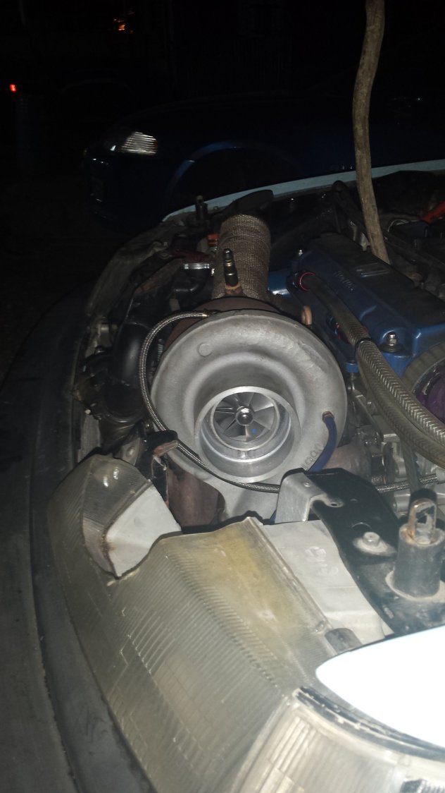

the turbo is a standard s300 168823 with a BEP 70AR turbine housing , i'm using it on a1600cc motor that's in my drag car .
i didn't buy a new compressor wheel as yet , i wasn't sure what to get as an upgrade .
