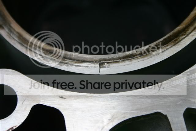

but anyways theres plenty of cracked sleeve b20's floating around
like this one recently:
I have a b20 myself- I just understand that i have got to be careful about it-
regardless get it tuned right and enjoy
