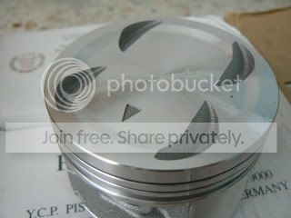

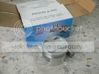

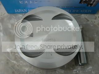

here's some pics i got left from last time.

Well the ycp's pictured above certainly don't seem like the tops car coated which is the main reason that the vitara's work so good in FI D series motors...
I'd definately be a lot more nervous about those uncoated YCP's than if they were coated similar to the Vitara's.

YCP vitaras aren't coated on top, they just have no machining done to the tops. The pictured pistons have quite a bit done, with the arrow and releifs clearly cast-in.
They also look like they are for stock non-vtec valves only, unless those are 84mm pistons. Where can they be bought from? I'm not finding any on ebay atm...
