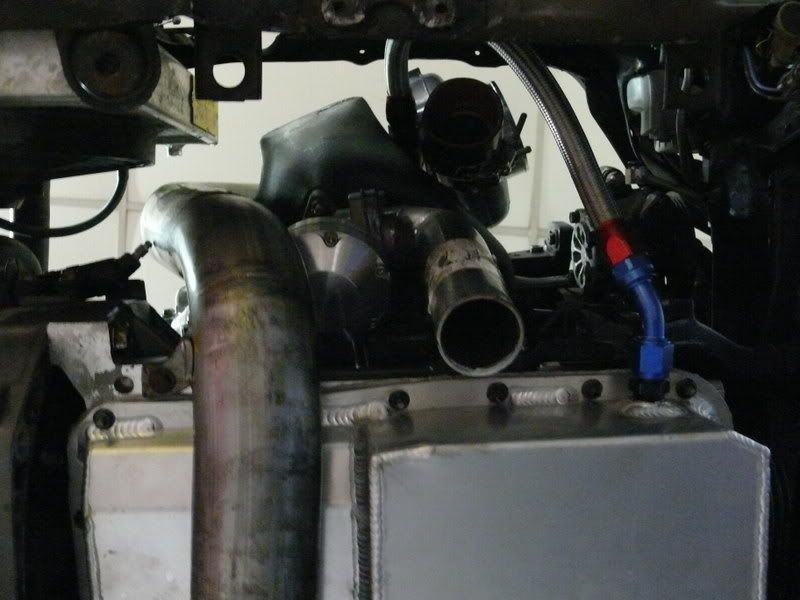

Originally Posted by Turbo-LS
The spa cast too mount works well though
Certainly looks doable, easier w/out but you would know best. Now, with your clocking flange, would this help or make it harder to clear the A/C compressor with the charge pipe coming from the turbo and the DP?

Originally Posted by Cole D
I wonder if having top mount with a v band flange gives you any additional space to clear a/c components
AFI (before they went out of business) had a real wacky looking AC ramhorn with a v-band flange for pairing with a T4 housing with a v-band on the turbine inlet..unusual for a street setup but I suppose with this you could easily clock the turbo however you needed for clearance even though this wasn't a topmount
